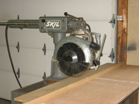

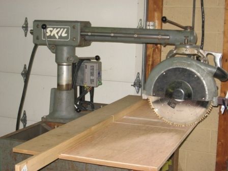

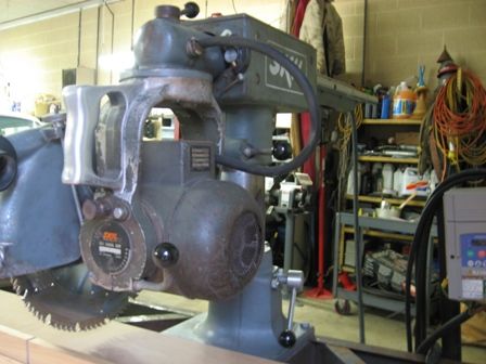

I purchased this saw off ebay earlier this year and had to drive nearly to Canada to pick it up. It needed everything: eight new bearings and two rails for the gliding arm, new cord, rip lock, anti kickback assembly, column lockdown, knobs and other pieces of hardware. The machine is 3 HP, 3 Phase, 220/440 V. I added a VFD from Hitachi and a new Freud combo blade and it is ready to work.
