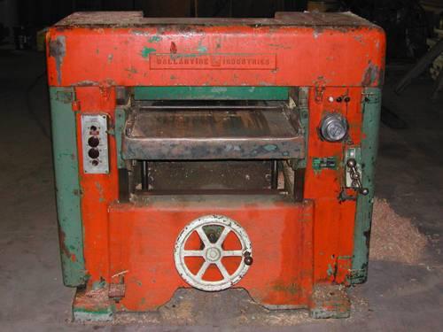

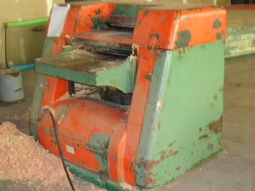

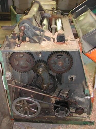

This is a VERY HEAVY and smooth running rough planer. It has variable feed rates, segmented feed with powered bed rollers and a fine thickness setting dial. The heavy guage sheet metal flat top cover is handy for stacking boards that need another pass etc.
The ID plate reads: "BALLANTINE INDUSTRIES, established 1932, capacity 24 x 6, type SS1-4, Absecon N.J., Patent Pending."

7 1/2 HP triple belt drive to the cutterhead with 16,008 CPM (Allis Chalmers "Line Start Induction Motor")
3 HP Feed motor (GE)
Original color: White (even though my business is called Shannon Woodworks I can't claim
responsibility for the Irish orange, green and white "paint job".
Frontal view

Outfeed view

Variable feed innards
