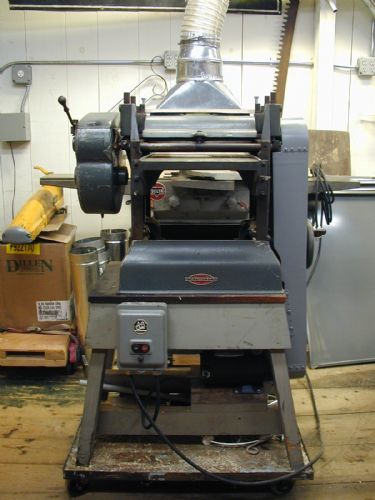

Purchased 1/30/02 via Ebay from just over the border in NY. In quite decent condition. Originally had a 1HP Wagner Electric motor that was highly anemic, replaced 12/06 with a newer Leeson 2HP. Changed pulley set to dual belts, swapped in link belts, and added an Allen Bradley motor starter. HUGE improvement in performance!
Front View
Myself
Shop made belt guard
Myself
Shop made exhaust hood
Myself
