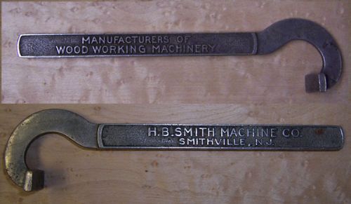

A similar nickle-plated brass (german silver)gauge was seen on a famous on-line auction site several years ago. I bid high and was quickly out-bid by another bidder and was not able to reconsider raising my threshold in the seconds that remained. For at least 3 years I've mentally re-lived that auction. I've sent an occasional email to the buyer offering to buy it from him (he's a railroad collector), but was never sent a reply. I seem to recall that the original item went for something in the $100 neighborhood.
A week ago my regular searches on that same electronic auction turned up a similar knife setting gauge. This was missing the adjustable brass shoe, but seemed in good shape otherwise. A work-related conference pulled me out of state for the auction end, so plans were made for New Jersey's anvilman to make the final bids. Strategies were discussed, thresholds were etablished, timelines were drawn in the sand, and cell phone numbers set-up for speed dialing. In the end, the gauge went to us for $10.50.... Wow!

Both sides of the gauge as received
My Kodak
