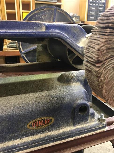

Sears Dunlap/Central Specialty 4"x36" belt/8" disk sander, model 103.08011, catalog no. 2213.
All bronze bearings feel good.
By design, only the idler roller has the rubber sleeve.
It appears to be missing the following: one bearing oil plug and the belt stop/fence.

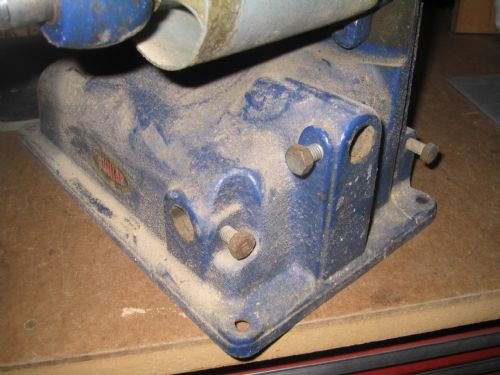

Component casting numbers.
103.592-37 Disk/belt sanding table
592_38_103 Table pivot
2159 8" aluminum sanding disk
592-2_103 Belt platen
5921.103 Base

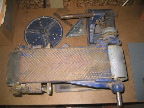

UPDATE-July 2007:
Found a belt fence (592-6) at a resale shop.
Used clear RTV to glue rubber sleeve to idler drum--runs and tracks properly now.

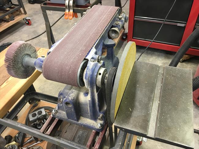

UPDATE-July 2018:
Attached sander to a Craftsman 16x30 Universal Stand.
The sander is currently powered by a Craftsman/Leland 1/2 hp 1725 rpm RI Oilite bearing motor.
A Chicago Die-Casting 5/8 bore motor arbor was added to the drive roller shaft end with a sanding flap wheel.

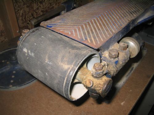

Idler pulley adjustment.
