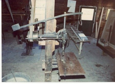

Grand Rapids Machinery Co. (Charles H. Tidey)
Grand Rapids, MI
small
Patrick Haire
postmount
1890's +
none
10/25/2006 12:00:00 AM
Iola Planing Mill drill press. Expected a larger drill press in this mill but it's sufficient and practical for general woodworking. It's difficult to identify, but chucked in this small drill press is a compound triple drill bit used to cut the mortise pocket in jamb for window sash pulley.
profile - belt to lineshaft
