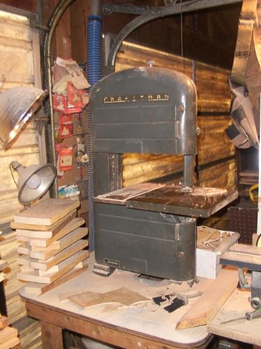

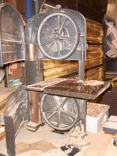

I bought this saw at an auction for $12.50(us) with no motor, stand, or blade and in need of desperate repair. I had a 1/2hp motor I had got from another auction for $2.00(us) and the table was a freebie. I had to replace the rubber tire on the bottom wheel and fix the homemade arm that adjusts the pitch of the top wheel. The blade guides are in good shape but rub the 1/16 blade I have on now. You get those plastic guides with a new blade but they are square and wont fit in the round holes. A belt sander will make them fit! I worked on this machine for a few evenings and now its quiet as a mouse and cuts great. It works better than my neighbors new one.
I have used this saw almost daily for a few weeks can ya tell?
I need a dust collection system!
