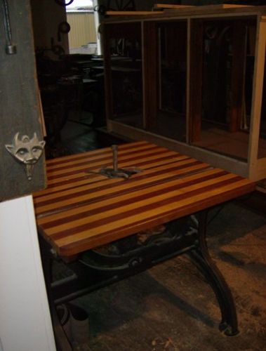

Found in lumberyard shop, Houston, TX. Cherry and maple top replacement of original wood top. Tilting arbor handy for quick changes in chamfering and roundovers using simple blades, but has been useful in difficult over or under cutting. Wooden tops on shapers like this make fence and jig attachment infinitely variable and quick to mount but is the reason why very few original tops are found in restorable or useable condition. Off line for awhile now but has been in use for the last 10 years.

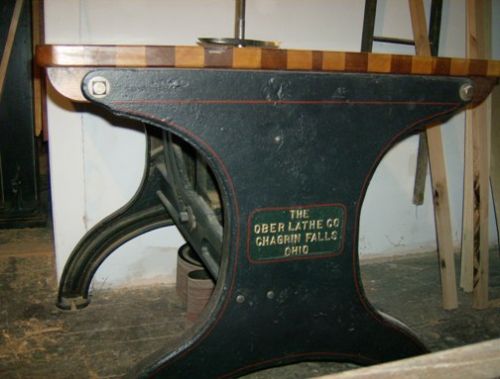

Comments: side viewshowing maker

Comments: wooden top

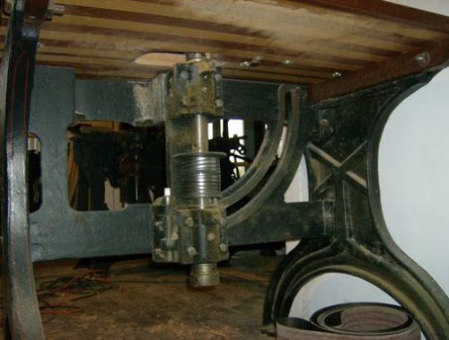

Comments: tilting arbor details-driven y seperatecountershaft
