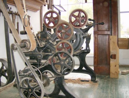

Oral history placed this mach. as coming from a small shop in or near Alton, Ill. Purchased from wonderful fellow in Shipman, Ill., a "collector from the past". A tough mach. to restore & learn to operate but gears, tooling, etc. were in remarkably good condition even though I declared it the crustiest mach. I've restored to date. Over 50 patterns were found, but hidden in two's & three's in 10,000 sq. ft. building on estate. Baseball bat patterns included showing the original operator was meeting all local demands. Catalog puts production potential at 27-30 ax handles, 60-100 spokes / hour.
Comments: showing gearing & cone pulley drive & simple rope\pulley to return cutter head to start position.
