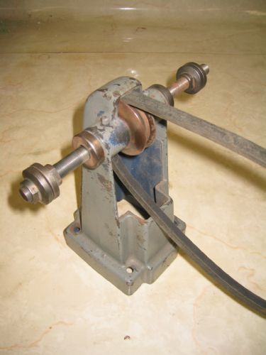

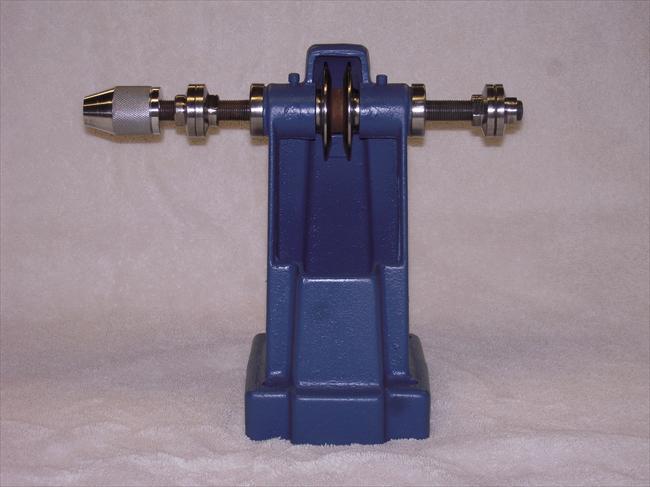

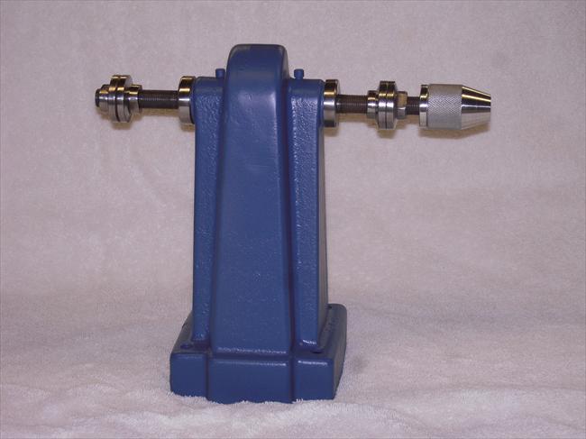

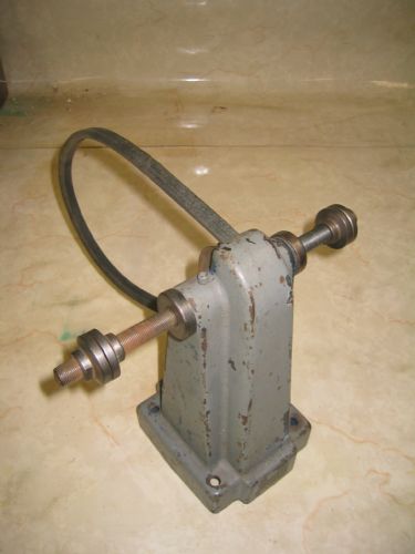

>>History<<
I purchased this polishing head on 8Sep2006 at a local used tool store.
I suspect that this polishing head was made by Millers-Falls for Sears, but can't confirm at this time.
September 2010: completed assembly.
Walnut shell blasted the casting (covered the bearing openings with blue tape).
Primer-Krylon gray
Finish-Krylon Oxford Blue Satin
Reversed the shaft so the RH threads are on the right side.
Added a 3/8" keyless chuck to the RH threaded end of the shaft (not easy to find in ½-24 threads).
Coarse and fine wire wheel to clean the steel parts.
Polished the flanges, cups, pulley and chuck with a Scotch-Brite EXL deburring wheel (grade 00 fine).
Comments: Front 3/4 view

Comments: Rear 3/4 view

Comments: Front view-restoration complete

Comments: Rear view-restoration complete
