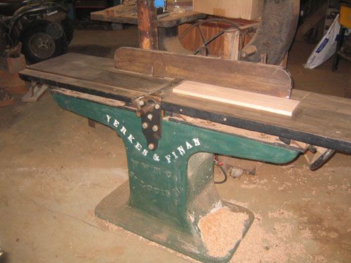

Yerkes & Finan 12" Jointer
early 1900's
9/5/2006 12:00:00 AM
This is the same machine as already on here, just improved some. I flipped the tables back the way they are suppose to be. Cleaned up the bearing mounts so they don't look like chunks of metal bolted to the frame, replaced bearings and painted. I'm not through with the lettering. My paint was too runny so I aborted the mission.
Lenny
Almost finished.
