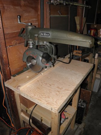

Here's my MMB finally, fully re-assembled and back in service with its new stand and Wally Kunkle table. Thanks to Roger Hill for his tips on rebuilding a DeWalt RAS, and Alan Eden at Original Saw Co. for providing current bearing part numbers.
Eugene Williams

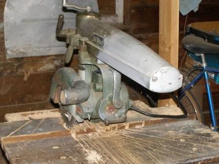

DeWalt MMB as it looked when it came home.
Eugene Williams

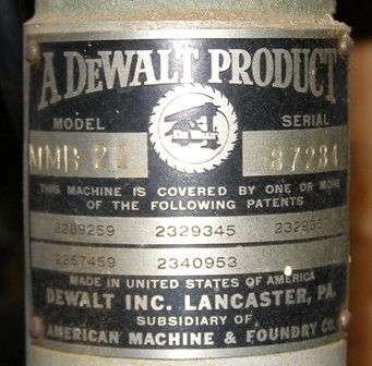

DeWalt MMB Nameplate.
Eugene Williams

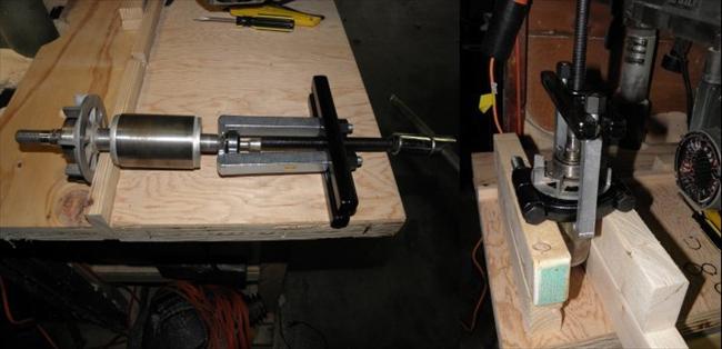

Removing the bearings with the gear puller and a split-bearing remover. The arbor-end bearing is nearly impossible to grip by itself, but by grabbing the fan with a split bearing remover, I pulled both the fan and bearing off as a unit.
Eugene Williams

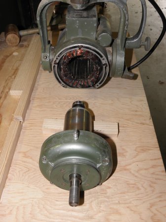

Here is the rotor and arbor end-bell re-assembled and ready for installation.
Eugene Williams

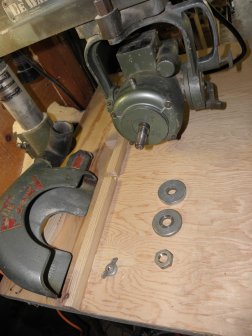

Here's the motor re-assembled and running. It's so smooth and quiet I have to be careful to remember to turn it off.
Eugene Williams
