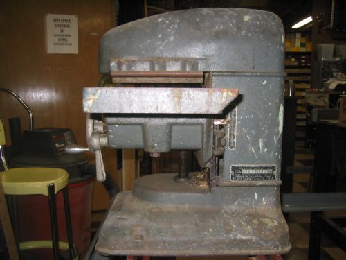

I purchased this machine with motor for $45 on 4May2006 at ReTool.
The ubiquitous (but classic) Craftsman/King-Seeley 6" manual feed thickness planer.
The knives are still sharp and it cuts fairly well, considering the amount of rust on the bed.
Missing are the knife setting gauge, in- and out-feed guide rails and the logo button on the cutter head bearing.
The motor is a 1/2hp 1725rpm Jack and Heintz model with sleeve bearings.
I believe that this machine is mid-1940s because of the model number (prior to the 103.23700 model number) and the label is a water decal of the Post-WWII winged Craftsman logo, while the base is drilled for tag drive screws. The paint is also Post-WWII Craftsman medium gray. This is just my theory.

Infeed side, sitting on Craftsman steel frame stand
Canon S230 with flash in the basement workshop
Front view
My Nikon Coolpix, existing light in my basement shop
