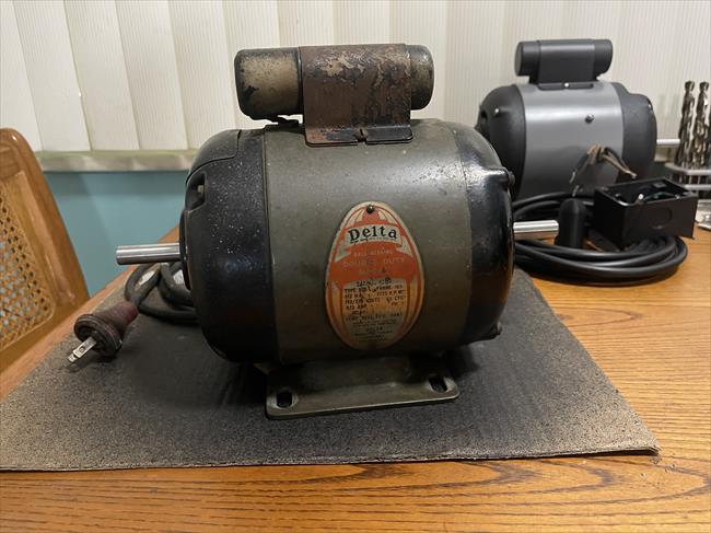

This one really runs well, smooth, quiet and no vibration. Surprising 80yr old bearings are still doing a great job. I hate to take it apart but it’s gotta get cleaned and lubricated, I owe it that.
The Id tag is not mint but it’s nice enough to reuse

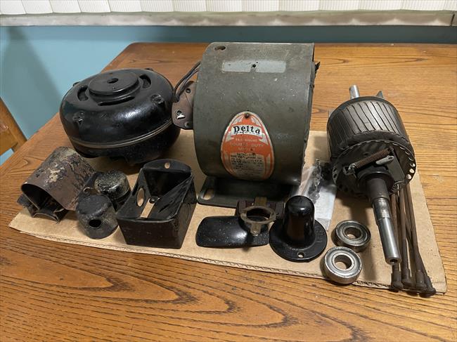

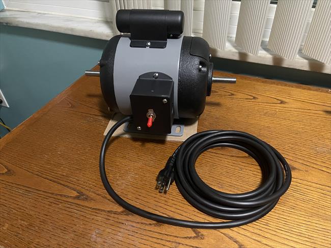

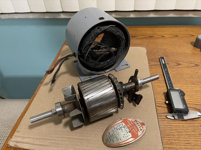

3d printed new grommets and fresh paint. Installed switch and bearings.
