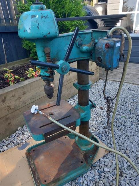

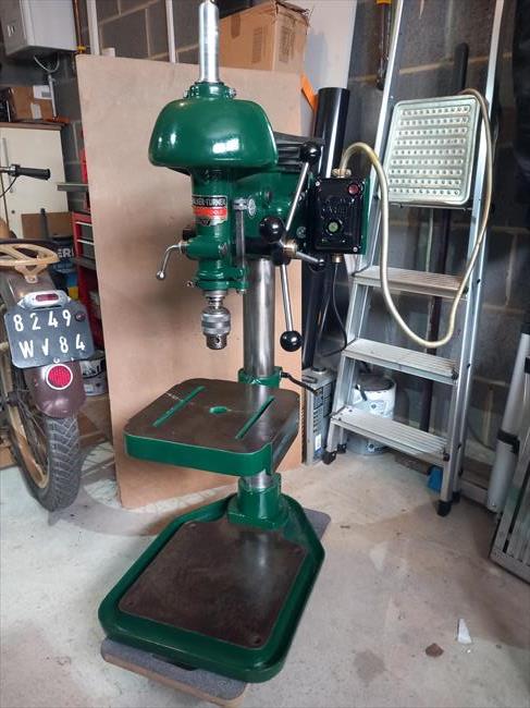

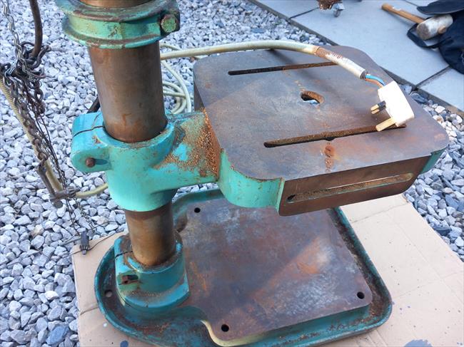

Picked up from local auction, not sure of the maker as badge was painted over and Walker Turner is not a common brand here in the UK. I got this for £25 ($31) and as per the pictures, it has had a life. Searching VM archives and with the help of Brian Kachadurian (thanks again Brian) I believe this to be a 1939 model, possibly supplied to Britain as part of the war effort. I say this due to the retrofitted British 50Hz motor, switchgear, the production base and tilting table with machined side plates. Original SKF bearing all still good and just needed a thorough clean and repacking. Other than replacing the wiring, the only parts missing were the depth gauge nuts and the oiler cap which I reproduced using pictures on VM and some artistic licence!

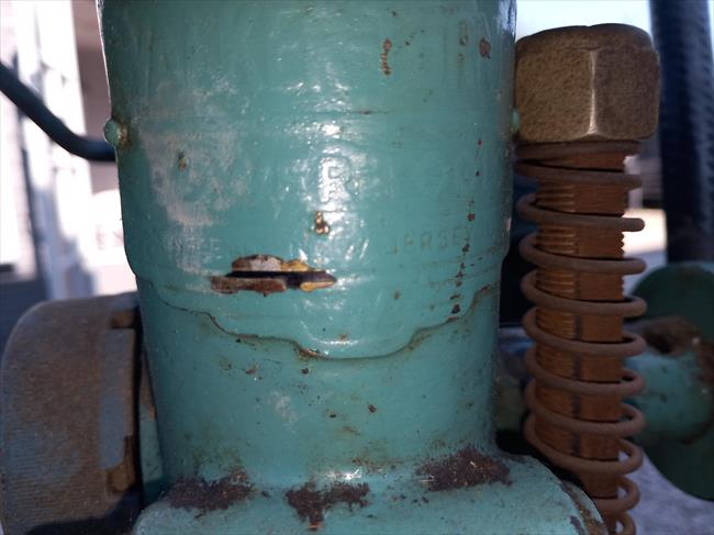

I am contemplating filling the “Arc of shame” holes with JD weld as I don’t want to not want to risk warping the table with heat. Whatever the solution will remain visible so appreciate any suggestions on this

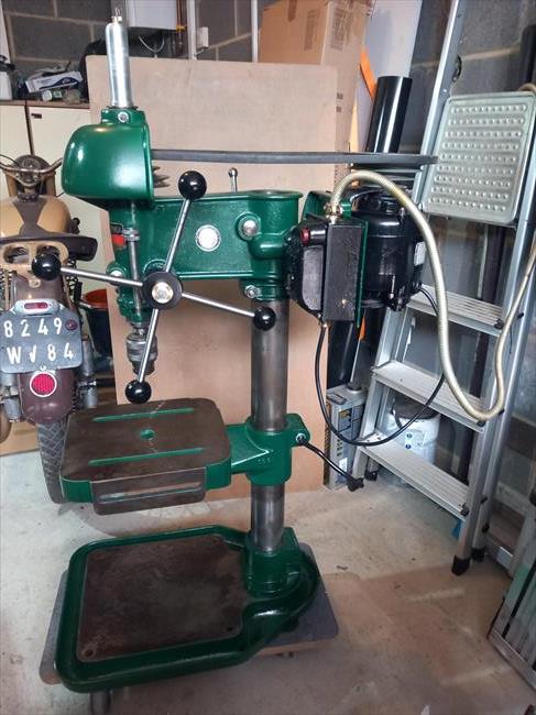

Turned out well but a heavy old lump,

As received

I like the table set up, I don’t think the 4 holes in the base are original as it is set up for coolant
