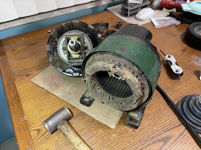

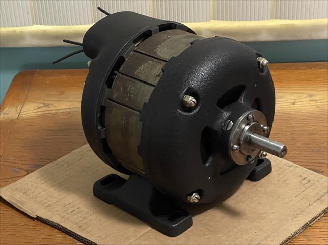

I have never seen this model before nor have I found one like it branded Walker Turner on the internet. The only model that I’ve seen like it was labelled Sears Commander Orange Band. It has tapered bearings and races which is also odd to me. Since the bearings use oil and it’s gonna be mounted vertically on a drill press, I’ll use a sealed bearing on top and the cone bearing on bottom. I have the perfect machine to use it on.

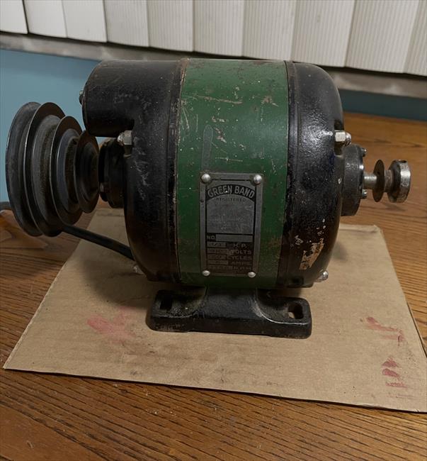

As purchased
Speaks for itself

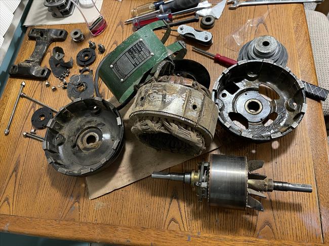

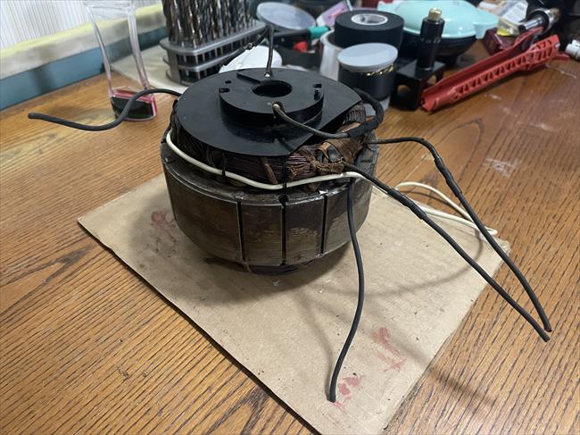

Exploded view

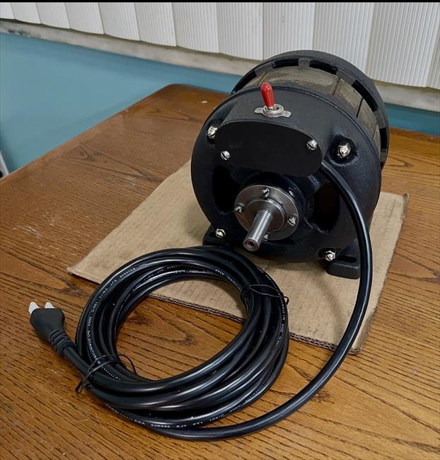

Made a new access cover, relocated power cable and on/off switch
