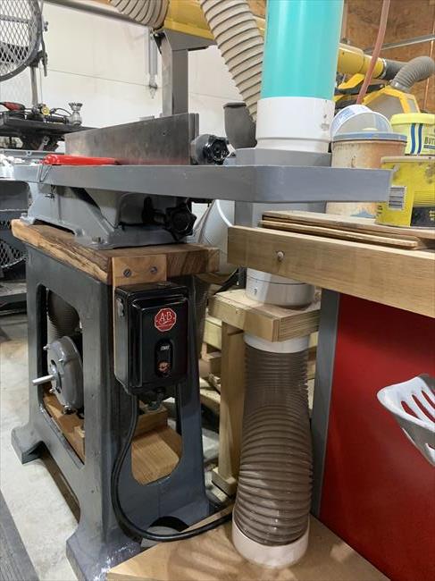

Note the JD Wallace bandsaw base. I think it looks good w the jointer.

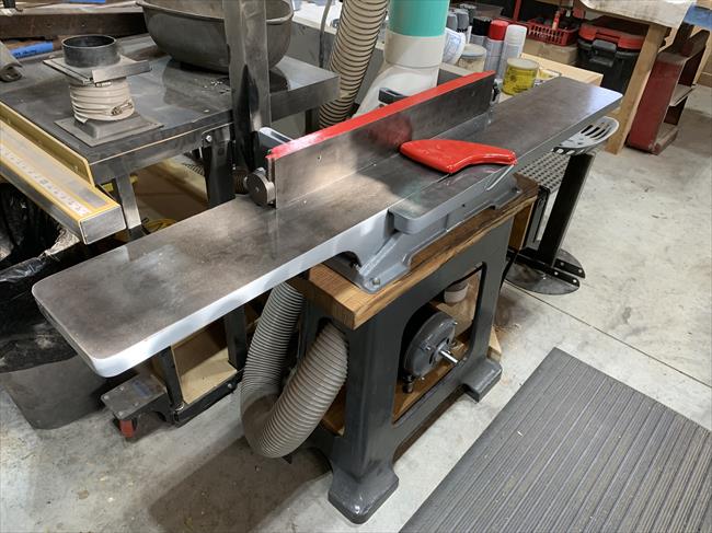

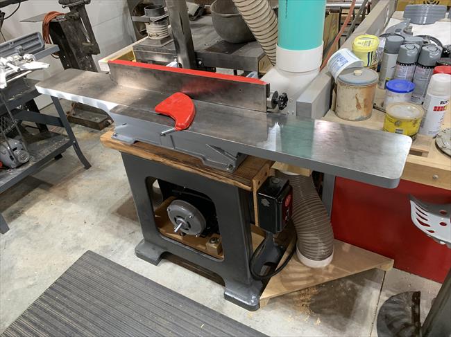

Good overall pic of the machine.
Had a cool old AB switch for it. Had to order different heaters.

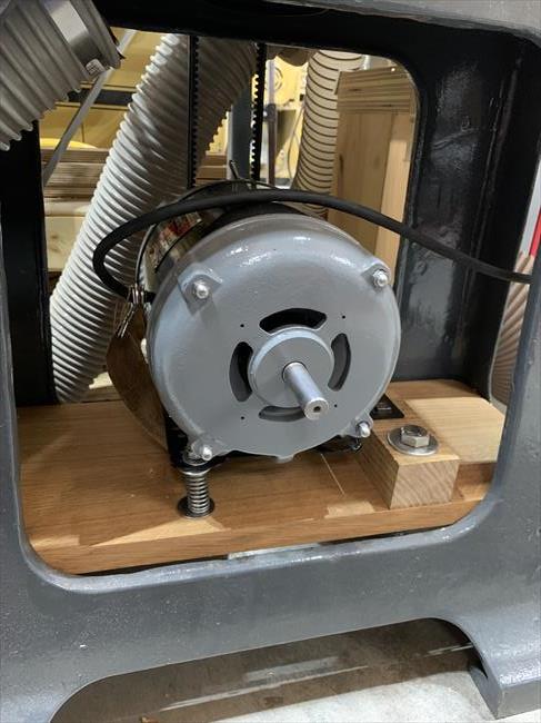

I made a “floating” motor mount with a spring loaded tensioner to take some of the slack out of the belt when running.

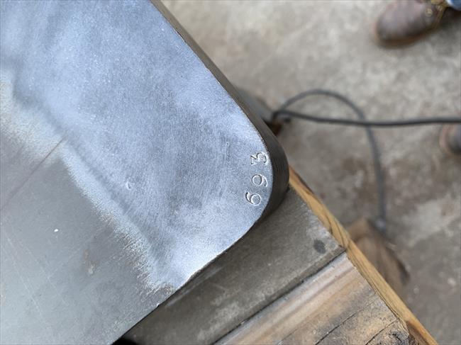

Serbian number 693.

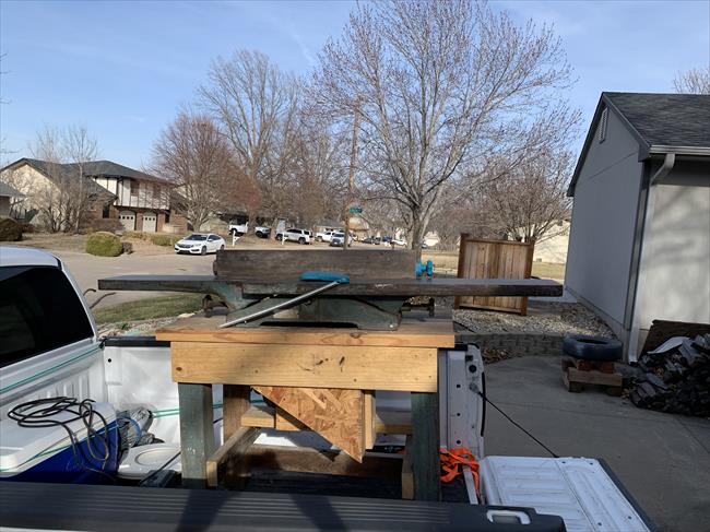

As found.
