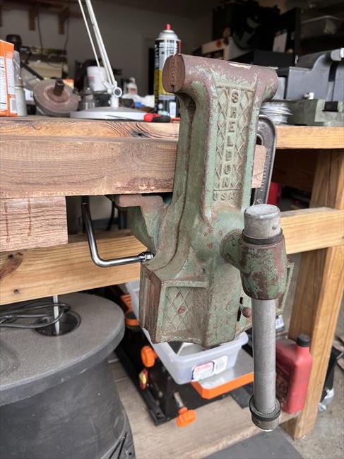

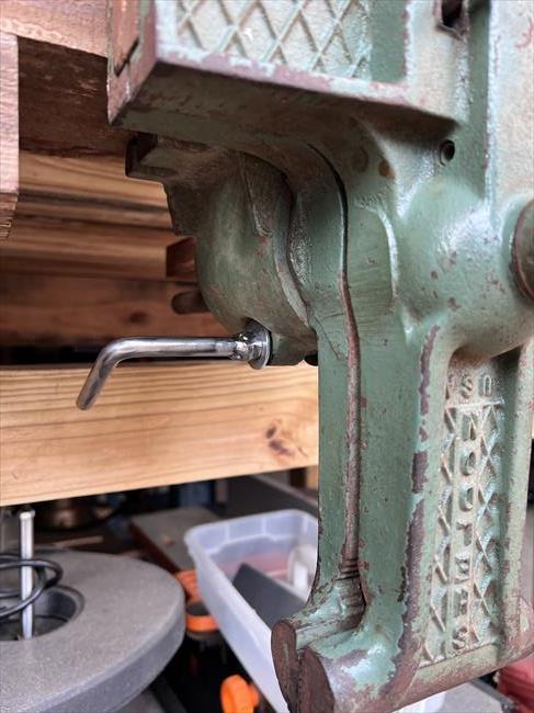

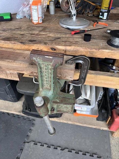

My wife and I won this vise at Arnfest South's raffle 4/11/2026. I don't have the name of the previous owner. It still needs cleaning up at this point and need a turret locking bolt. I made a bolt for it and tested it out. I found a video of the same vise on Youtube and copied that locking bolt. the locking bolt is 8 inches total length bent at 90 degrees at about 3 1/2 inches, with about 1 inch of 3/8 x16 thread. I drilled out a 3/8 inch nut at 25/64th so it would slid over the threads and I could weld it on the rod at about 1 7/8 inches from the bottom of the threads. The vise fully opens up to 7 1/2 inches from what I can determine at this point. Here is a link to the vice as it works now with the fabricated bolt. https://www.youtube.com/shorts/QlTFbiAeSeE
Temporarily mounted / clamped to to a board.

View that shows the new locking bolt / handle.

Another view of the locking bolt after rotating the vise.
