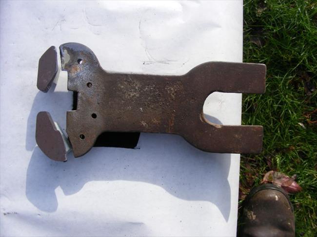

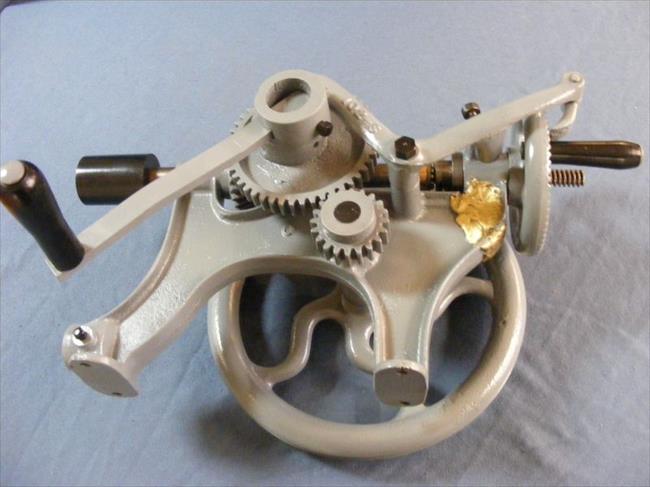

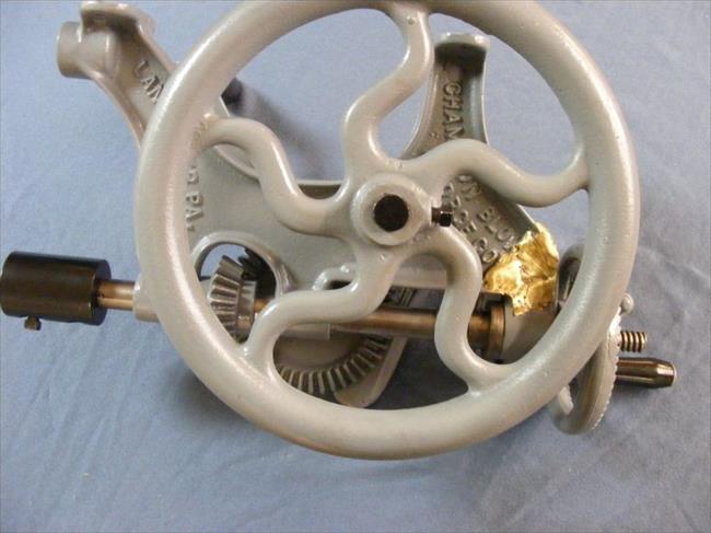

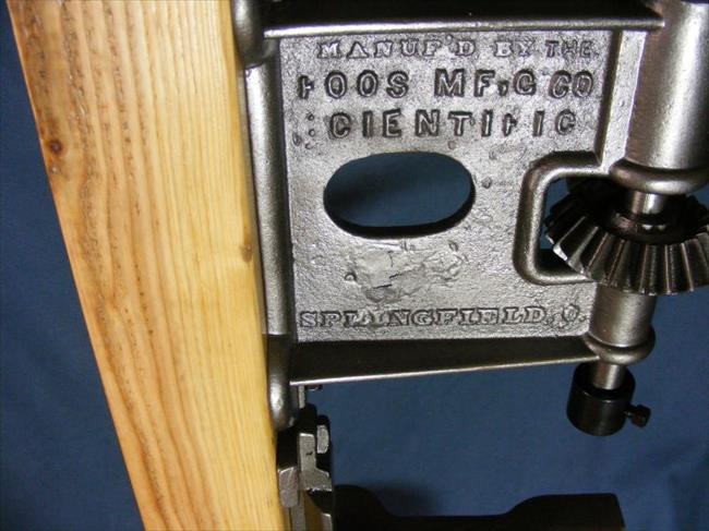

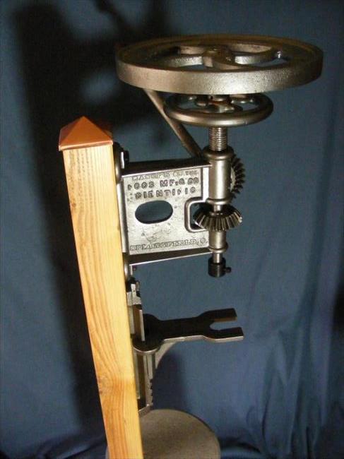

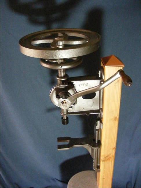

I acquired this machine as three pieces from the shop cleanout on a very old farm east of Yamhill, OR. The Foos head had been replaced with a Champion 102{?} head, then something broke it. The upper spindle sleeve on the head had been repaired but I had to make a new return handle and complete crank. The Foos table-to-ratchet-column ears were gone and replaced with a 3/8 plate screwed on. Someone apparently failed at repairing these. I fitted and brazed new proper ears on.

Foos drill logo side
my machine and photo
Foos drill crank side
Foos logo
repair pieces Foos table
My machine and photo
Champion head flywheel side
Champion head gear side.
