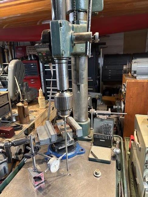

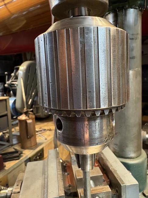

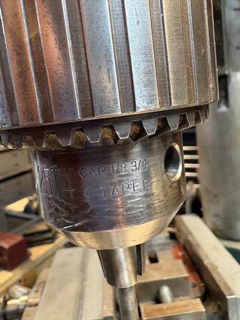

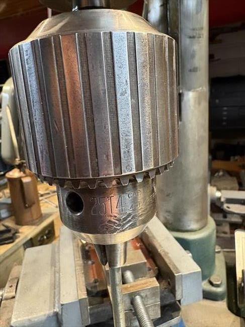

This is the largest chuck that I have found. It had a J4 MT4 taper that didn't fit any of my machines. I removed the taper and replaced it with a J4 MT2. The MT2 is puny but when I installed it on my drill press, there was virtually no runout.
1 of 3 front view

2 of 3 front view

3 or 3 front view

On the press
