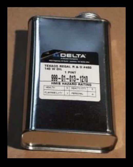

Many questions on the gear oil for these planers. Ran across this and felt it needed to be posted to eliminate misinformation. Texaco Regal R&O #460, 140W oil.
Comments: Can of Rockwell/Delta planer gearbox oil
