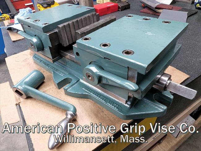

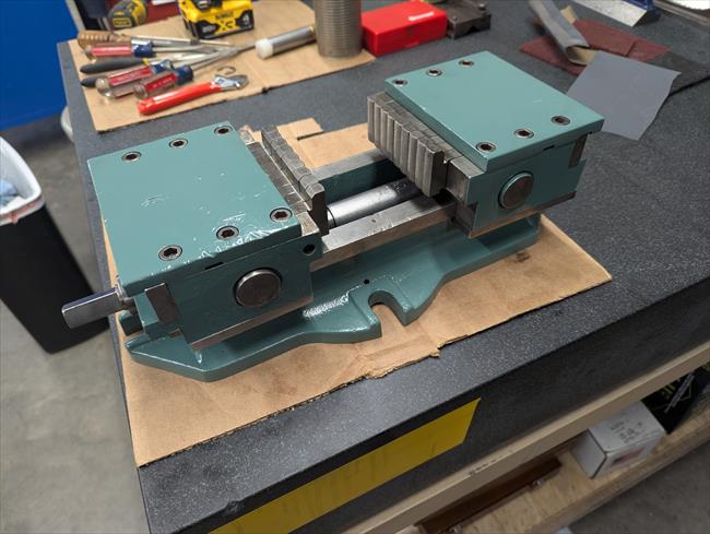

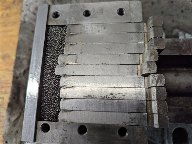

I purchased this vise in November of 2025 north of Everett, Washington through a Craigslist ad and refurbished it to smooth working condition.
After refurbishment Nov 2025
Matt Rulla

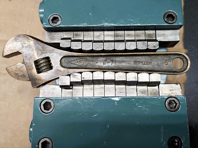

Jaws conform to work

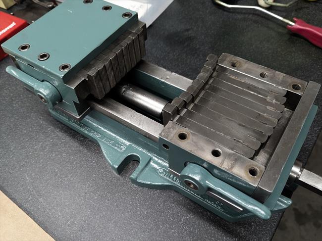

steel balls removed from reservoir for cleaning. Note the jaw fingers and thin spacers.
Matt Rulla
Top removed to show steel balls filled reservoir

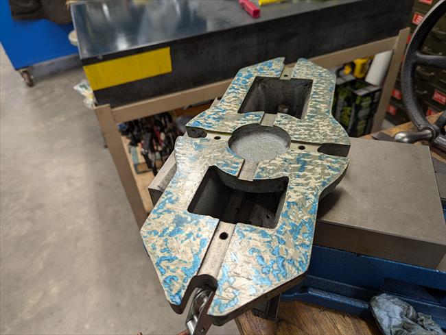

hand scraped base

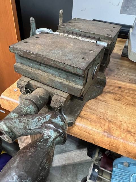

"As found" condition from original craigslist ad
