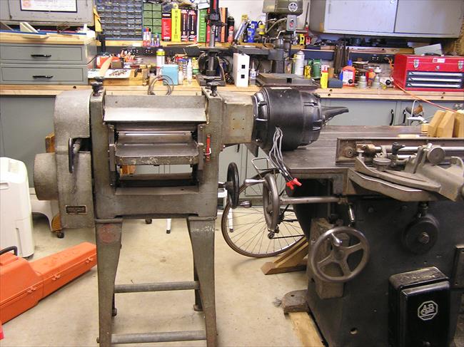

Boice-Crane Co.
Machine Type: Planer, Wood
Machine Size: 12"x 4"
Submitted By: Ray Muno
Description/Model: Model 1002 "Little Giant"
Date of Manufacturer: 1930's
Last Updated 10/5/2026 4:21:07 PM
Boice Crane planer. 1930'vintage. "Little Giant"
Peerless 1-1/2HP Repulsison Start, Induction Run motor.
Factory cast iron stand.
Replacement knives from Woodworkers Tool Works were
12-1/4 x 5/8 x 1/8, Set of 3 (Fit Boice Crane)
Very heavy for a 12" planer. 535 pounds without cast iron stand. Stand adds another 100 pounds.
Unusual in that it has a cast iron belt guard. Catalogs indicate it was introduced in 1930. Cast Iron belt guard looks to be used 1930 through 1940. Replaced by sheet metal guard in 1941.
