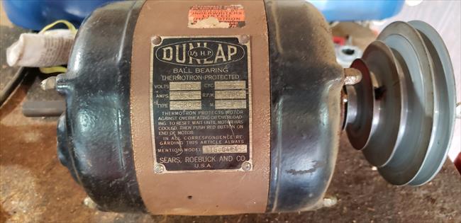

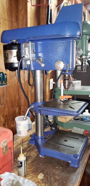

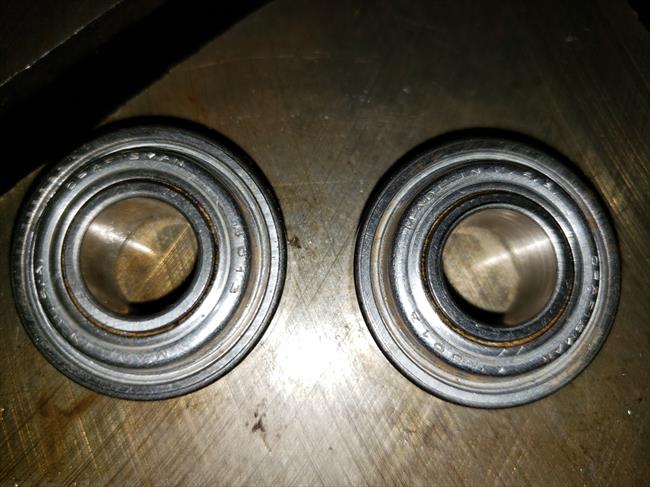

CL find Sept 2025, from an estate. I have given it a good cleaning, lubrication, and rewired the power connection to provide grounding. The spindle bearings were surprisingly smooth, and tight, but the Dunlap 1/3 hp motor bearing grease had dried to paste. I soaked them in WD40 for a day, sprayed them with carb cleaner(they were only shielded on 1 side), to flush them out, and repacked them. I had to cover some of the motor's internal, cloth-insulated wiring with heat shrink, due to deterioration of the cloth. In case anyone reading this doesn't know, the mohawk is a cover for the spindle. The quill has to be lowered partway, in order to open the cover, to change the belt speed.

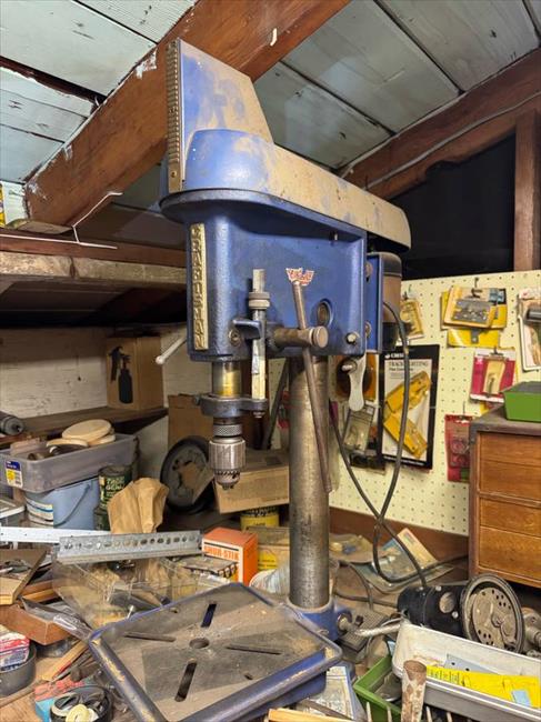

This is the condition I purchased it in. Lots of dust, light surface rust, and dried out oil. It had sat for decades, but had been well-lubricated during its years of use. It came apart surprisingly easily.

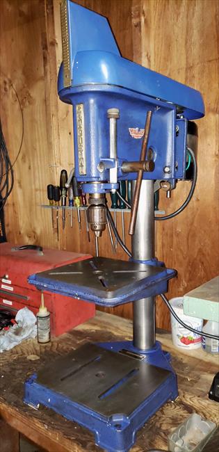

This is after a lot of cleaning, a little light sanding, and fresh machine oil
Thats all original Craftsman Blue(except for the white house paint the original owner spilled)
Here's the nameplate from the motor- before I cleaned the motor

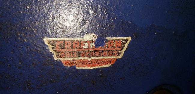

The remains of the Craftsman Bearings sticker
The motor bearing numbers
