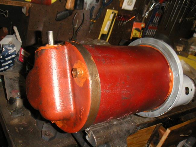

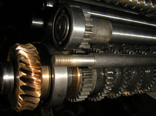

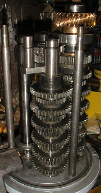

These files show the insides of the gearbox from an Abene VHF-3 mill - this gearbox drives a shaft that drives the table in X,Y,and Z - reversing the motor activates the rapids, so there is an idler gear visible near the top.
If you have one of these, it's best not to take it apart - but if you must, remove the input and output shafts, then unscrew the four nuts holding the assembly together, then pull the back off - you will need to use a pry bar to press the brass gear down as you do this - that will push its bearing out of its mounting hole.
This is very nicely made, notice all the ball bearings - all the gears ride on double pairs of needle bearings - this is fine Swiss workmanship - this particular mill was made in 1970

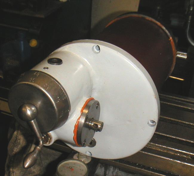

These files show the assembled Abene VHF-3 gearbox that drives the table.

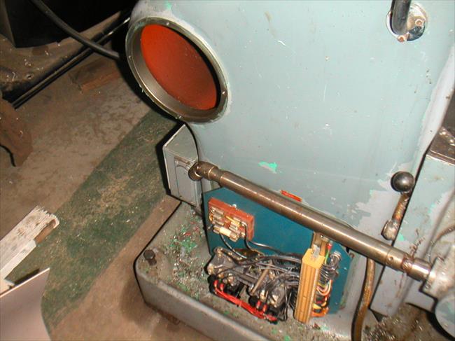

The higher numbered photos (3,4,5) show the mounting point in the mill and what is inside the mill body (e.g. the drive motor)
VHF3 table drive gearbox internals
my photo
VHF-3 table drive gearbox assembled

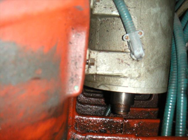

2 HP motor that drives the table, flat belt pully at bottom of photo

where Gearbox fits into VHF 3 mill, switching relays at bottom of photo

side view of gear train, VHF3

gearbox, outside view, VHF3, sightglass is below selector handle, output shaft points to right side of photo
