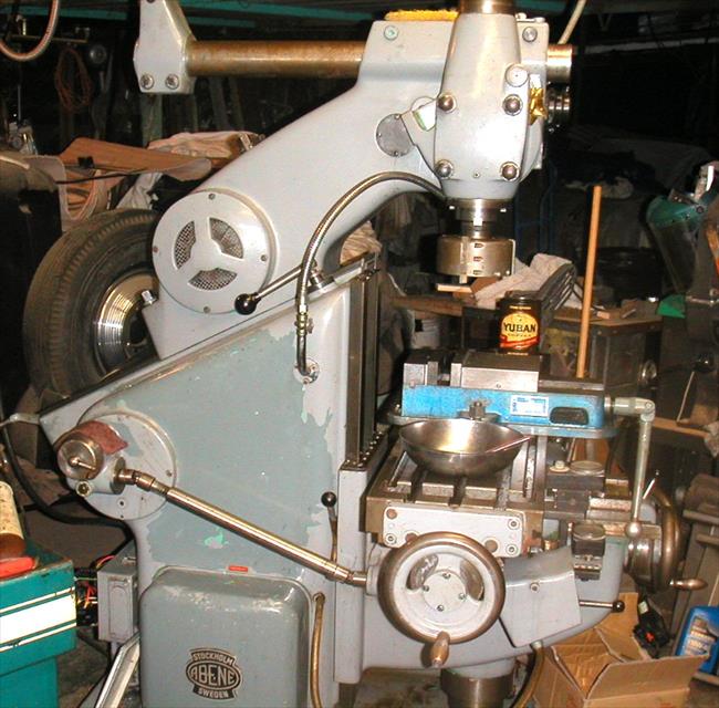

Comments: Abene VHF-3 side view

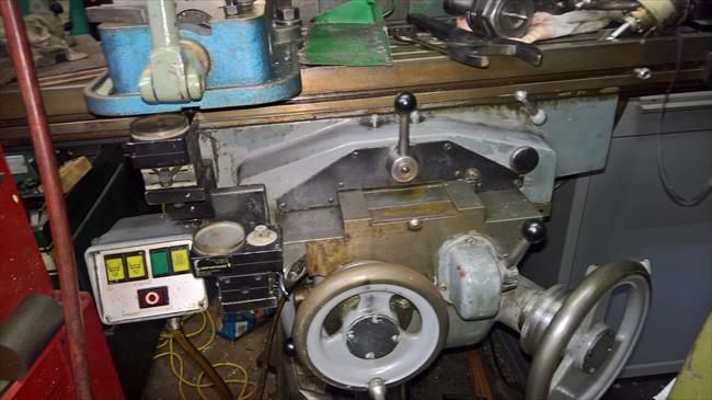

Comments: Abene VHF-3 control station

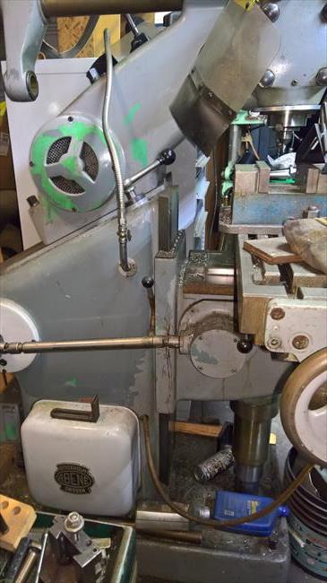

Comments: VHF-3 side details

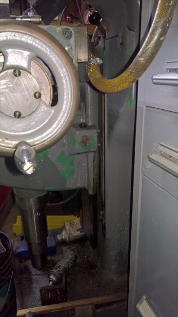

Comments: VHF-3 looking at right side
