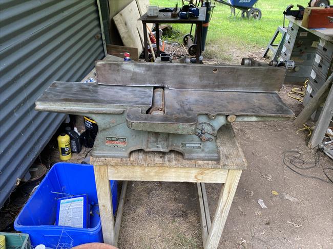

$45 from the Habitat for Humanity Restore in Brevard, NC. No motor, no stand.
Replaced bearings with Triton model 1623-2RS-PRX sealed ball bearings from Grainger.
Looking for crown nuts for table height adjustment knobs; hard to find, 1/2" diameter, 24 threads/inch.

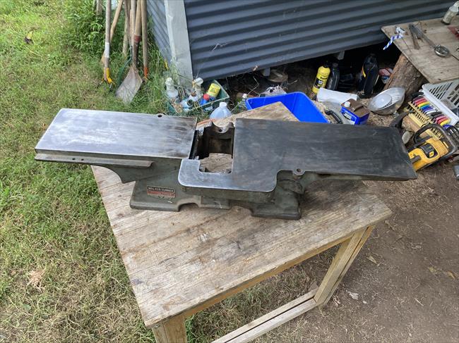

Not badly rusted, but some dents were distorting the surface of the lower table (on the right in the first photo after sanding). Nicely resolved with a belt sander with a 120 grit belt.
Wondering what would be the maximum safe cutting head rotation rate for this machine?
Comments: Tables after sanding
Source: Me
Comments: After reassembly
Source: my photo
