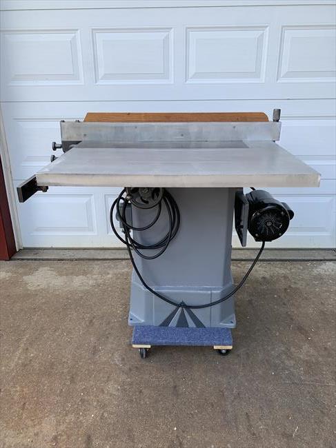

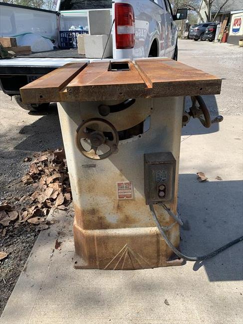

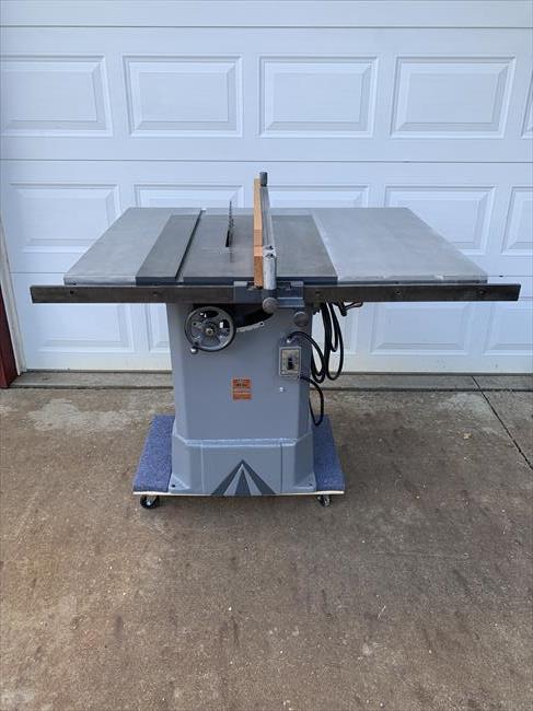

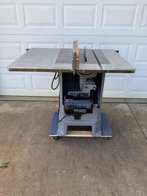

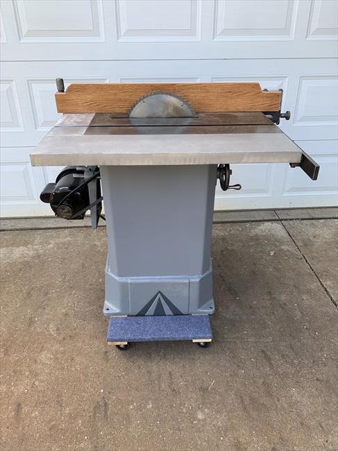

I picked this saw up in Wichita, KS for $50. It belonged to a “antique store” that was downsizing due to a health issue with the owner’s husband. I believe it sat outside for some time. The motor is not original. Other than that, it was complete and bears the original fence. It had the usual problem with the elevation shaft, so I had it turned down and put a bronze bushing on the shaft where it passes thru in order to raise the blade. My thought was that while it would wear faster than the shoulder of the original steel shaft, any future repair would be much simpler - just replace the bushing. I sold it to a gentleman from Texas who was moving to Colorado and wanted to outfit his new shop w OWWM. He also purchased a DP 220 from me for the same purpose.
I just love that art deco triangle on the front. The dark grey really makes it stand out.
These are 12” saws. I use a table saw a lot and still find this kinda scary.

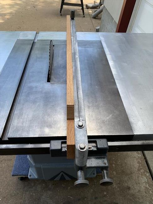

This is one beefy fence.
As purchased.
