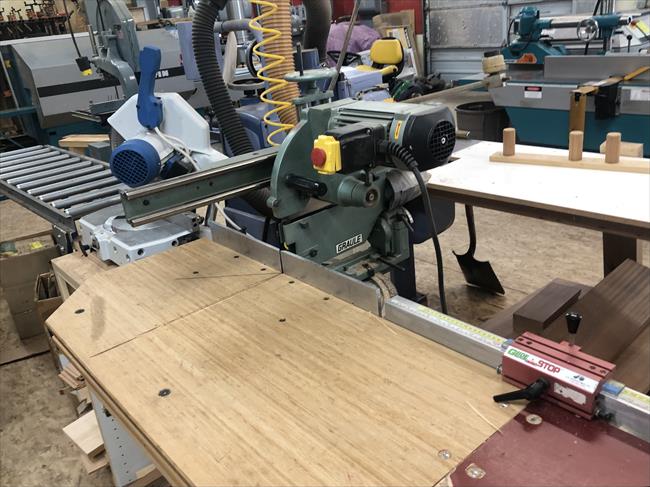

Right side with Glide Stop fence

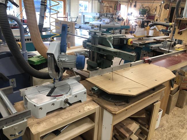

Left Side

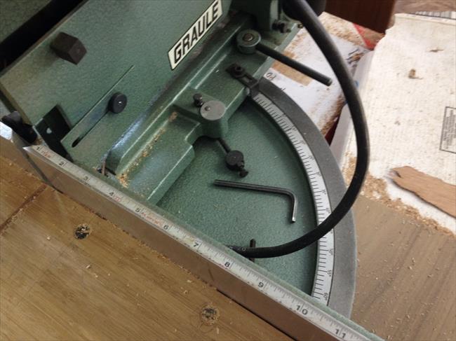

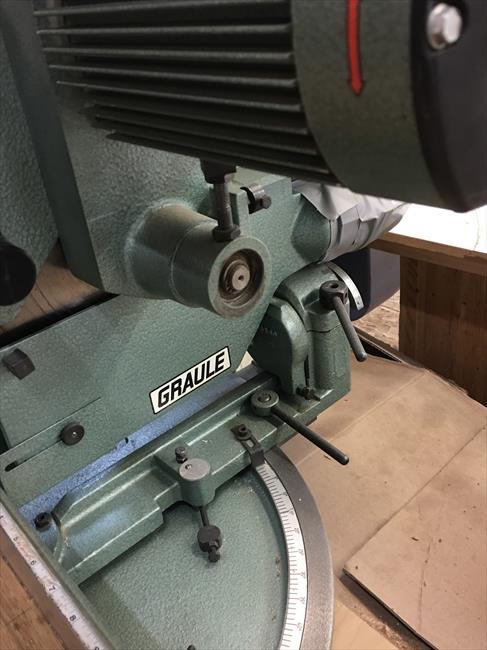

Angle scale
