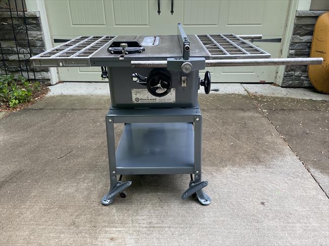

I thought I'd better document this since this model is not common and I've found very little info regarding this particular model.
I purchased this in April of 2025 and completed the restoration in May of the same year.

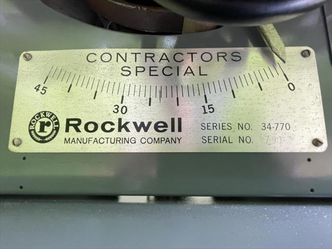

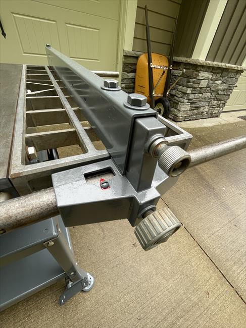

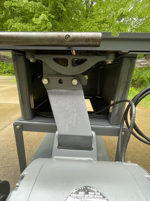

This is the heavy duty 10" Saw that was likely offered in the Industrial catalog. It is very similar to the 34-426 model with the heavy duty arbor carriage. It is easy to spot because the tilt stops are adjustable from the top. It is unique in that it has the same sized fence rail tube that the 9" saw has and a similar head but the fence is long enough to fit on a 10" saw.
The serial number does not coincide with any of the Delta/Rockwell numbers found on this site.
