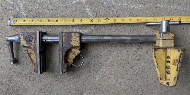

Description/Model: Float-Lock Safety Vise
Date of Manufacturer: Circa 1952
Serial Number: NA
Last Updated 6/24/2025 8:38:03 PM
I purchased this vise on eBay. It came with part of an early mounting bracket. I did a little research on the inventor and company and included it below. This may be an early version (1952-1953) because the casting says patent pending.
Float-Lock Safety Vise and Inventor Henry Persson (1896-1976).
Henry Sigfrid Persson was born in Braknehol, Sweden in 1896 and immigrated to the US in 1922. His brother Tage came a year later. Henry was an engineer/inventor and along with his brother, Tage, had many patents. In 1945, Henry and Tage lived in a house that included a small, attached machine shop named T.G. Persson Co. at 224 Glenwood Ave in Bloomfield, New Jersey.
In 1949 Henry filed the first patent for the Float-Lock Vise, and it was assigned to Float-Lock Corp, Bloomfield, New Jersey.
In 1950 Float-Lock Corp introduced the first Float-Lock Safety Vise.
In 1951 the patent 2,552,580 was granted to Henry.
In October, 1951 American Machine and Foundry (AMF) purchased Float-Lock Corp. AMF marketed the Float-Lock Vise under the Wahlstrom/Float- Lock Brand. Wahlstrom was another company AMF had acquired that made drill press chucks. AMF continued to use the 224 Glenwood Ave in Bloomfield, NJ address as well as Float-Lock Corp. or Wahlstrom Float-Lock Sales Dept., American Machine & Foundry Co., 511 Fifth Ave., New York, NY.
In 1953, AMF announced in the Modern Machine Shop magazine that they completely redesigned the new AMF Float-Lock to be faster, huskier, greater in capacity (9” and 12” jaw openings). I think they added a slight angle to the table locking clamp to add some force to hold the vise on the table. This new design is immediately visible in the thicker ratcheted jaw face plate.
