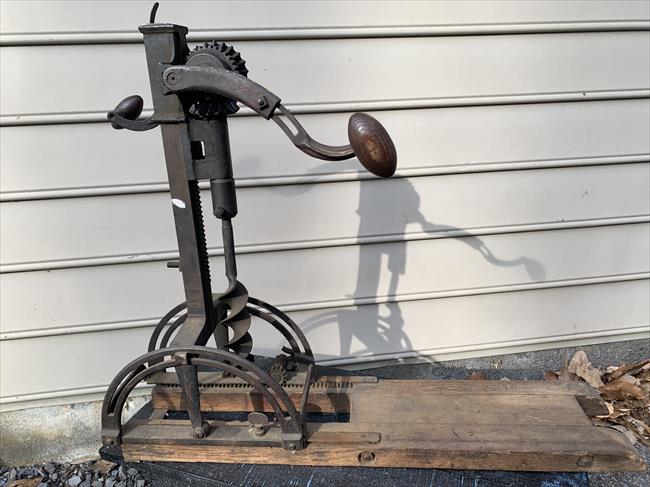

I purchased this mortise machine at a local PA auction for restoration and addition to my collection. The machine was in excellent mechanical condition just needing cleaned and refreshed to display condition.

Recovered condition side view with rack and pinion slide adjustment shown on far base frame.

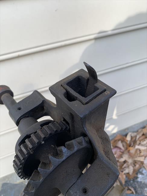

Top of hollow cast iron standard, release lever and gear headstock

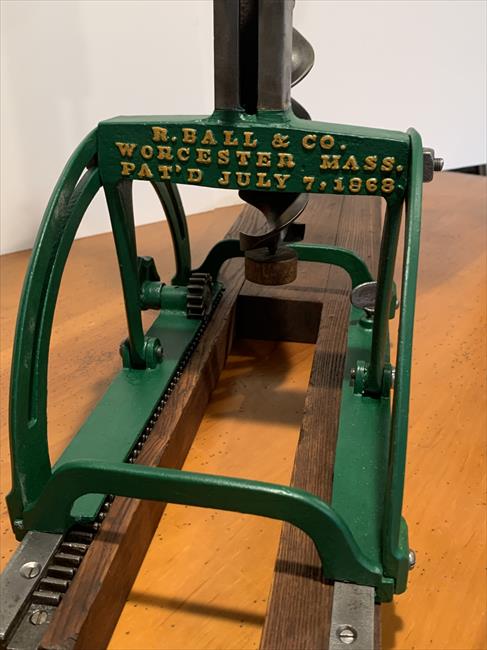

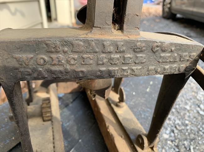

Pivoting angle adjusting standard with manufacturer name and patent date

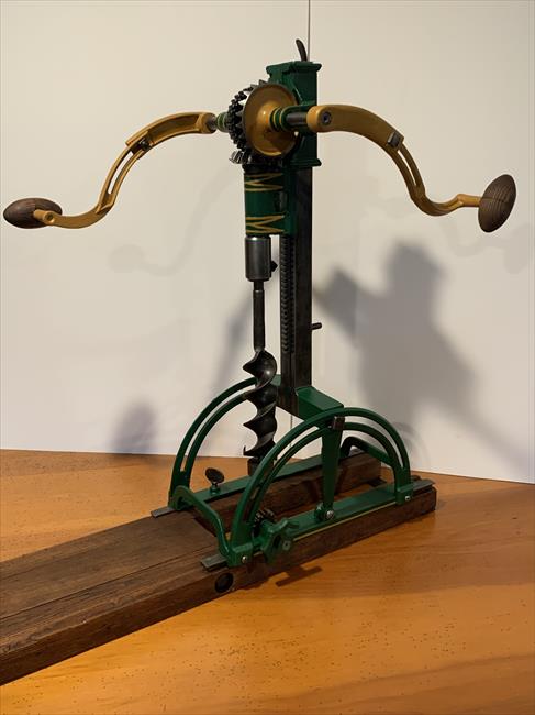

Restored machine showing the adjustable crank handles for increased leverage with larger augers or harder woods. The paint pattern was discovered in the cleaning process.

R. Ball badge and detail of the patented angle pivot and rack and pinion slide adjustment system.

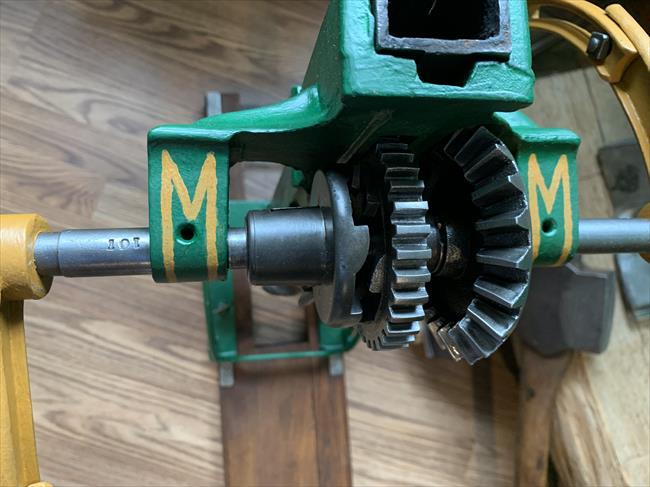

The serial No. 101 is hand stamped on the machine 6 times, on the standard, slide assembly, crankshaft, headstock, cog wheel and crank handles. Bit drive gear on right, the sliding cog engages the center pinion on standard rack for auger withdrawal.
