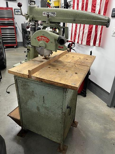

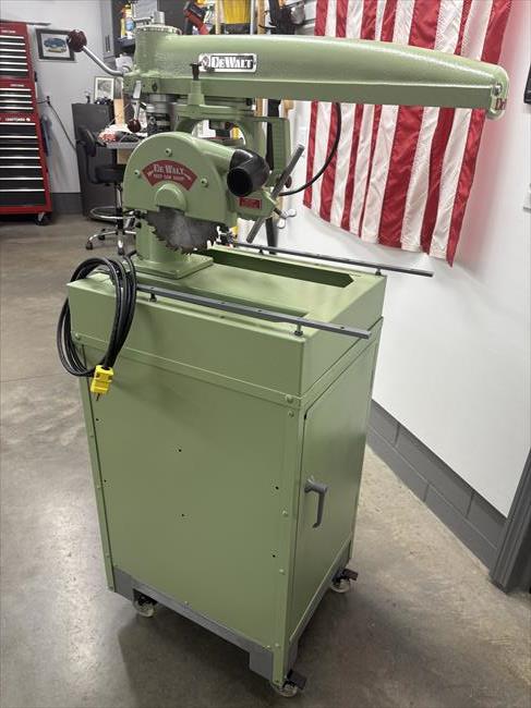

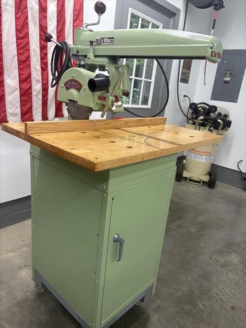

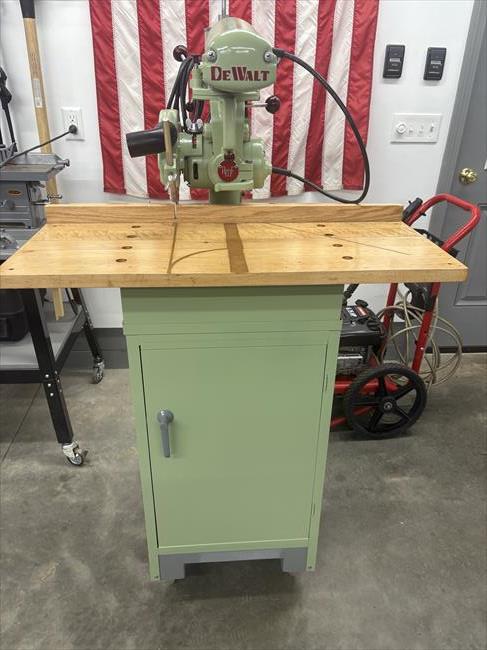

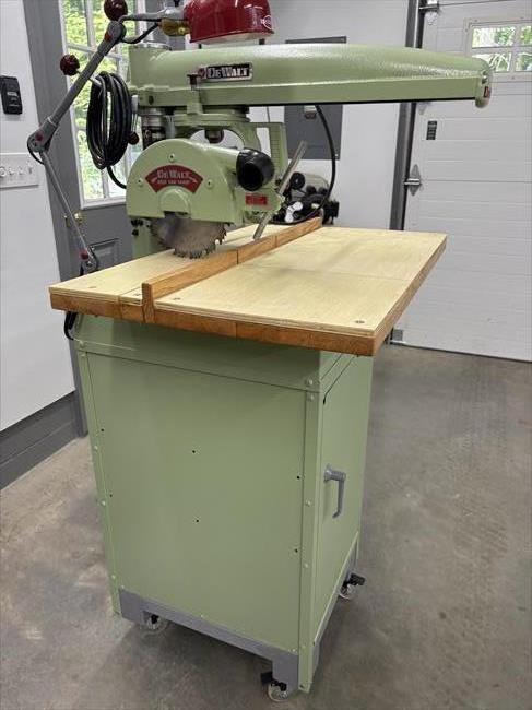

Found this radial arm saw in April, 2025 buried in the basement boiler room of a local church. They were beginning to renovate the building and needed to clean out years of collected debris. The little DeWalt had been unused for years. The motor turned, but every other adjustment was stiff or seized. Electric cord was dry rotted with bare wires. The saw was mounted to the 35” steel cabinet (#119900) that was an available option for the Home-Mate model. With the exception of the kick back device, the saw was complete. It even had the manual, instruction book, catalog price list, & sales literature safely stored inside the cabinet. The saw was completely disassembled in my shop, cleaned, repaired, and repainted. Still needs a new table and final adjustments. Soon will be ready for another 70+ years of service.
First day in my possession.
Reassembled without a table
