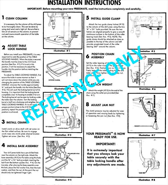

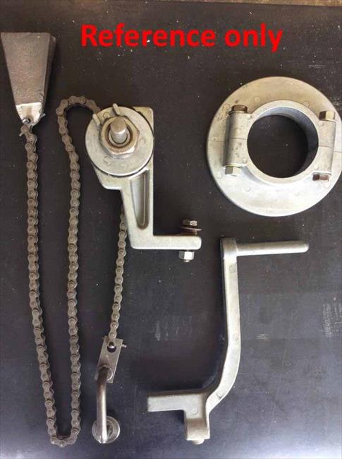

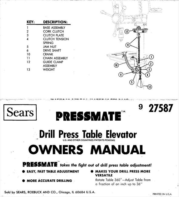

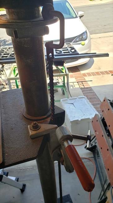

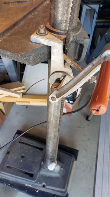

Sears #27587 PRESSMATE, Drill Press Table Elevator. A Rare find- It came with the purchase of Craftsman 113.21371, 15-½” Drill Press. Some photos below were retrieved from internet for references.

as installed
my phone
installation instruction 1
my scanner
installation instruction 2
my scanner

complete package
internet
as installed
my phone
