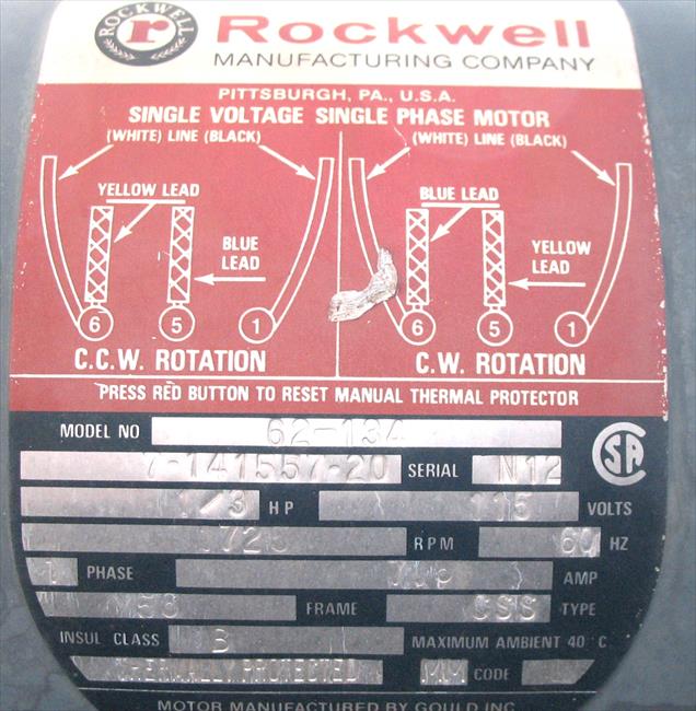

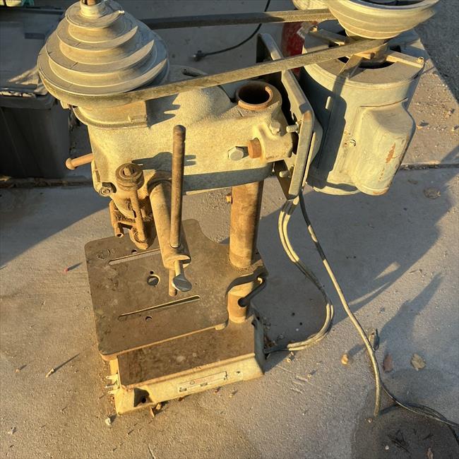

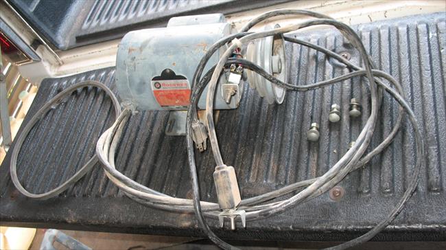

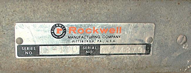

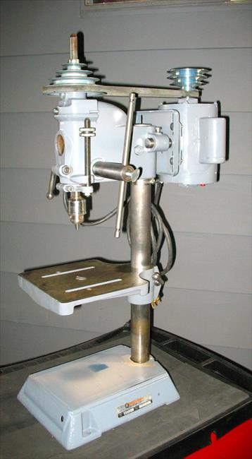

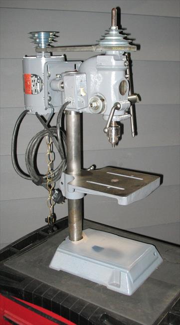

Found this Drill Press on Craigslist Website. It had 2 switches attached to 2 cords. One cord had an ON/OFF Switch, the other cord had a 3 position switch, center off, Right and Left, was wired to reverse the motor from Clockwise to Counter Clockwise, so I assumed, maybe, the previous owner used this little Drill Press for Tapping. I couldn't get the 4 stage motor pulley off, so ended up having to cut it off with a hacksaw, thus had to order a new motor pulley from MAX Warehouse. Also the front, cast-iron Safety Pulley Cover was missing, so if I can find one reasonable, I will replace it. The Paint I used to restore the drill press is: Rust-Oleum Professional can spray paint 15 oz, fast drying (15 min), Paint Color is: Gloss Dark Machine Gray #7587. The Motor, looks to be the Original. It's a Rockwell, 1/3 HP, 1725 RPM, 120 V. and seems to run just fine. I just put a simple ON/OFF switch on the Drill press, to control Clockwise rotation.
Left side view-Finished

Series No.
ME-Canon PowerShot 630
As I found and bought it
Motor Plate Info.
Motor with 2 switch cords.
