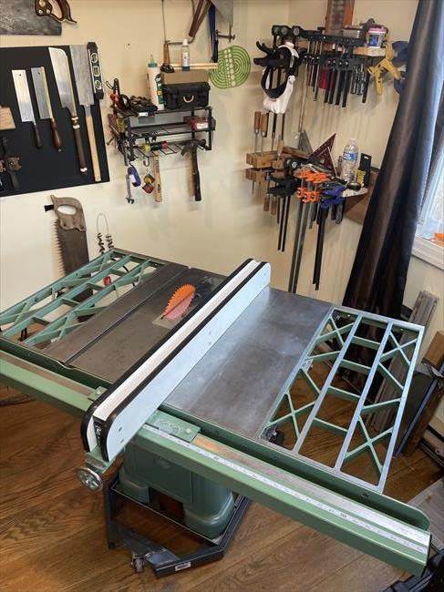

While looking for a drill press on Craigslist. This was in the garage covered in dust. I bought it not knowing anything about vintage table saws.

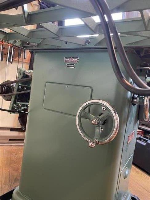

I’m not sure what year it is. I’m still looking for the reason there’s a name tag like this one. Then there’s the same saw with the atlas name in script.

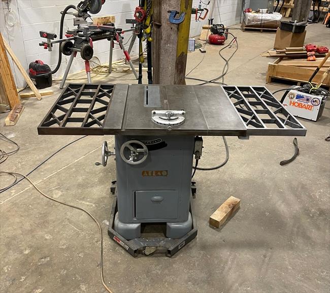

I’m still looking for the correct extension wings by atlas. These are from craftsman. Atlas wings are 27.5” all other saws are 27”. So I made 1/2” filler piece of mild steel. The last thing to do is to fabricate the blade guard out of aluminum.
If anyone has any more info on this saw it would be much appreciated.

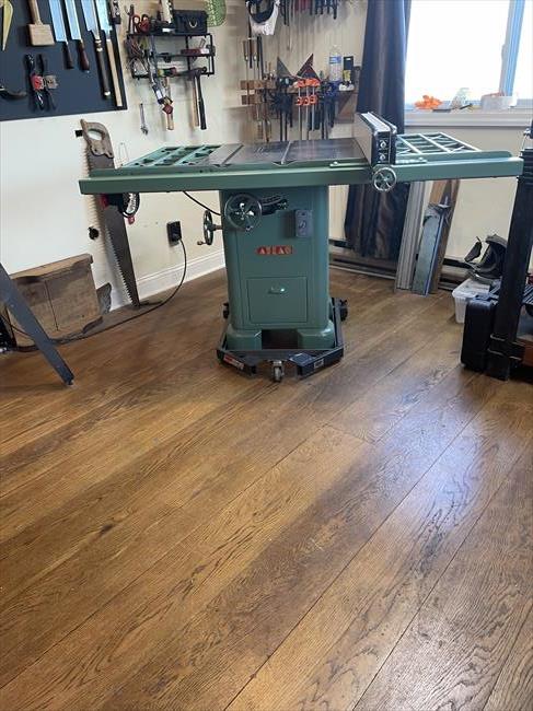

S10f table saw

S10f all new tag by vonindustrial

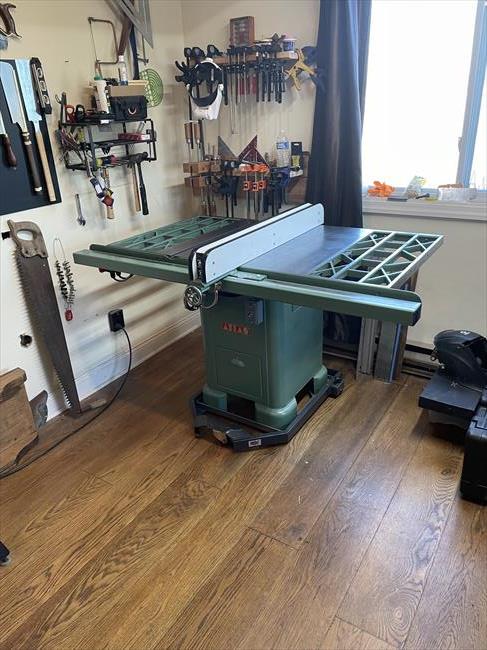

S10f table saw my version of biesemeyer

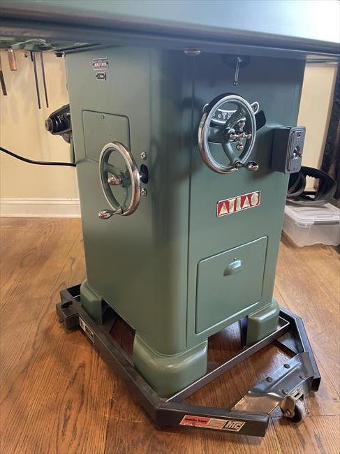

S10f table saw
Jimmy Graf owner and restorer

S10f table saw before
