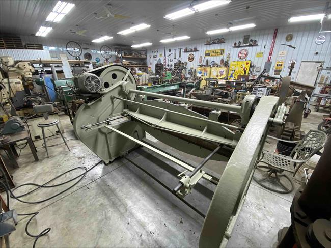

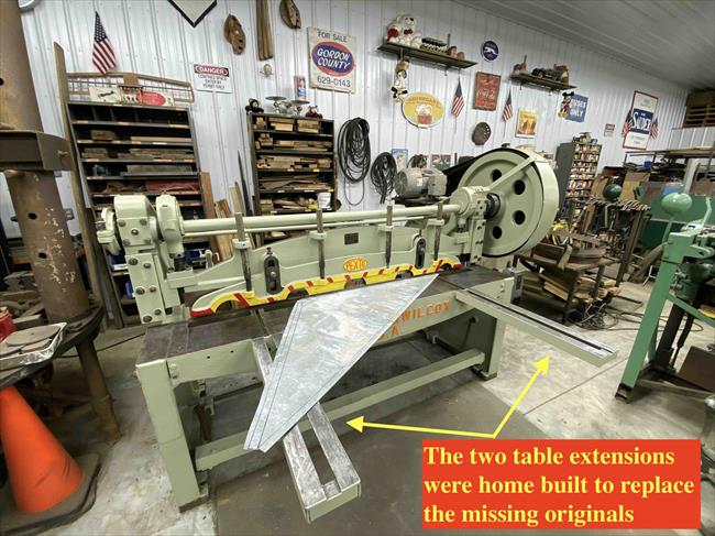

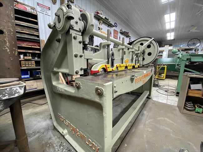

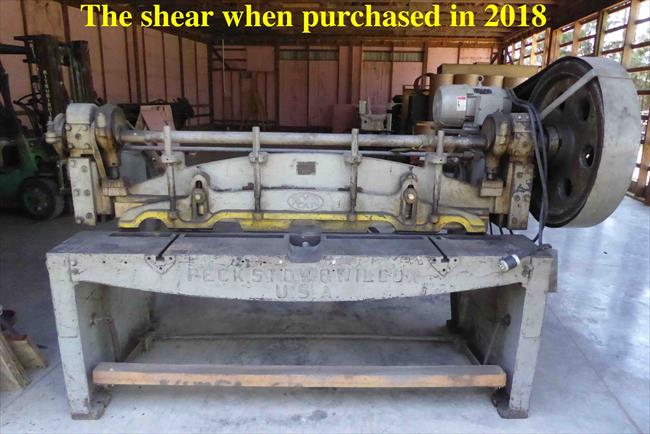

In 2018 the company no longer needed the shear and I became its proud owner. Being so heavy, it took two fork lifts to load on the moving truck that would bring it the half hour trip to my home. The 3-phase motor, bearings and cutting blade were changed more than once over the years. However, not much is otherwise different from when it first came off the production line over 80 years ago. Most of the 2024-2025 restoration time was spent cleaning, scraping, sanding, wiping, painting and re-greasing bearings. Electrolysis was required to remove rust from certain parts like the back stop. A new ON/OFF switch holder and two table extensions to replace missing originals were also built.
After cutting countless 1000’s of square feet of sheet metal in support of WWII, Korea and Vietnam aircraft production followed by peacetime use it only seemed fitting that the girl got a makeover. And now, thanks to her original built quality, she is working as good as new.
The shear after 2024 restoration

The shear when purchased in 2018
Personal photo by Randy Sauder

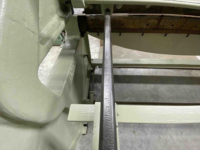

Back view showing the adjustable back stop.
Left side of the back stop.
