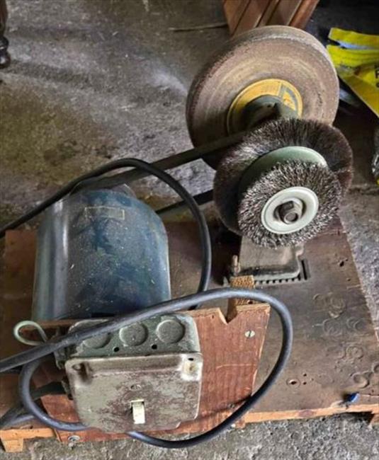

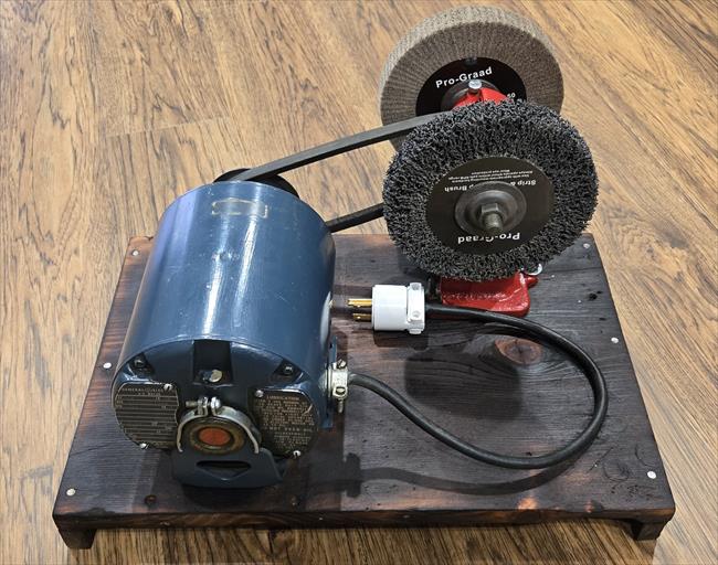

Purchased on Facebook Marketplace with a worn shaft and missing bearings.

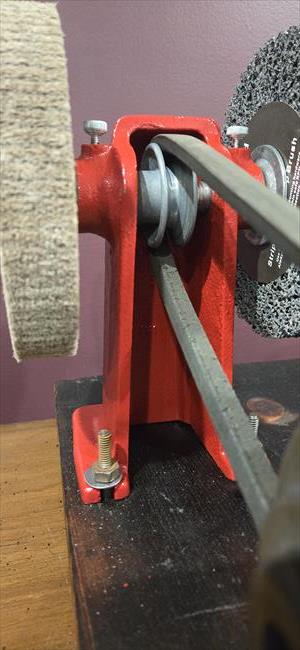

Used a 3/4 OD X 5/8 ID oilite bushing to replace the original bearings. Cleaned up the shaft and it's operating nicely.

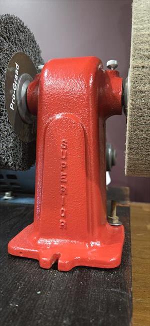

Prepped and painted with Duplicolor Engine paint (Universal Red-DE1653).
Comments: Post Restoration

Comments: Rear view
Source: My camera

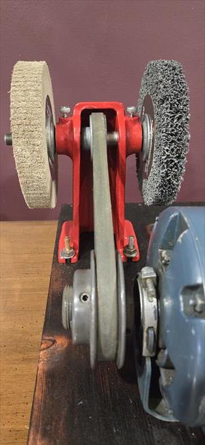

Comments: Rear view
Source: My Camera

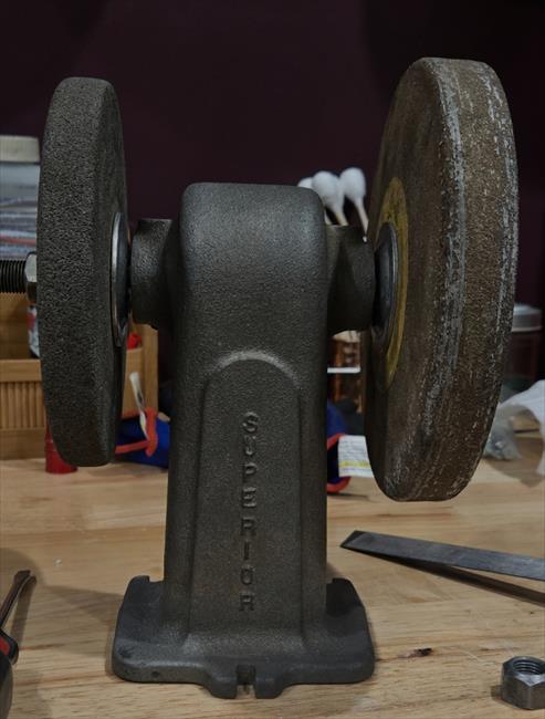

Comments: Stripped to bare metal
Source: My Camera

Comments: As purchased
Source: Facebook Marketplace
