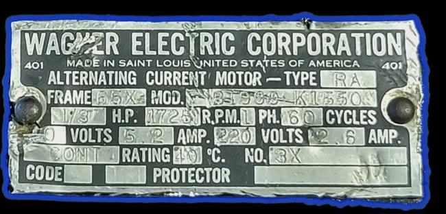

Wagner Electric Corp.
St. Louis, MO
Motor
1/3 hp
Eric C
Repulsion induction
1950
K1550
10/12/2024 1:56:26 AM
Came with a very junky machine for parts and motor as it's a brush lifter repulsion induction motor. Since it is a lifter motor the brushes and commutator do not wear much at all. Keep some oil in the resevoir and the bronze bearings don't wear much either. Had to strip about 4 layers of ugly paint off and repaint.
Red color outline added on picture. Had some copper coated parts that were left unpainted
