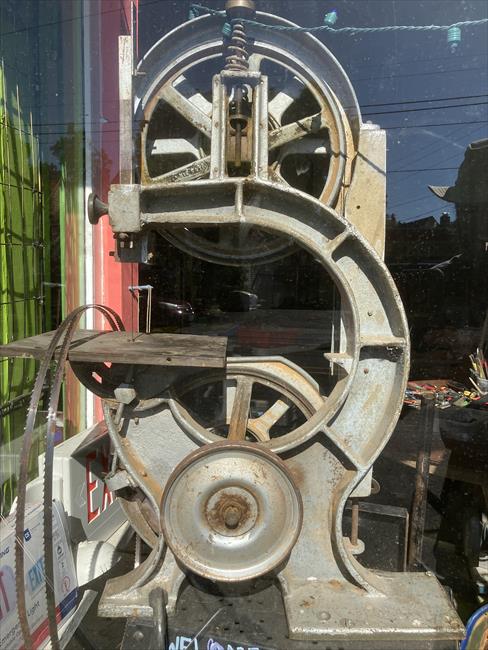

It has taken me a few weeks to solve the riddle of this bandsaw which showed up recently in a local store shop window. The C-frame I could tell was very close (I would eventually determine an exact copy of) the saw made by Elmer Knight which I own. From Elmer Knight’s son I learned back in 2011 that his father made exactly two copies of this saw. The other one he had given to his good friend Gus (August) Crabtree. So how to explain this third saw, which featured an all but identical frame but differed in a bunch of other respects? Notably this saw has a pair of cast snowflake guards, a five-spoke lower wheel, and the various machined accessories, notably the guides and knobs were made with far less care and attention than the one on Knight’s own saw. Furthermore, the words BAND SAW are cast into the frame, a spoke on the upper wheel, and the underside of the table. And finally a name was stamped into the top edge of the upper guide. I only discovered this name from a photo I took in the store, and my attempt to return to the store to retake that photo to learn the full name did not succeed as yet.
Anyway, the mystery is resolved because I remembered that Elmer Knight returned to his alma mater Benson Polytechnic High School as a teacher. It strikes me as almost certain that he supplied the pattern he had made for his own bandsaw to the students, one of whom made this bandsaw. Elmer Knight I have now learned taught at Benson in 1935 and 1936.

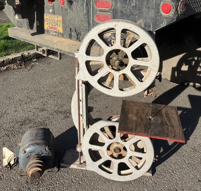

When it was finally mine: about to be loaded
Own photo
rear view in shop window
me

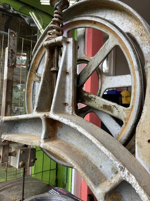

upper half of saw from left rear
me

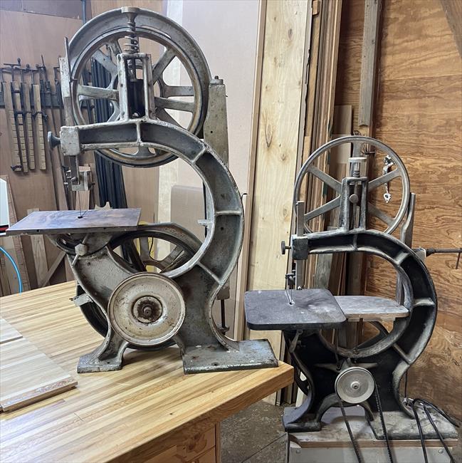

Alongside the Elmer Knight saw
Own photo

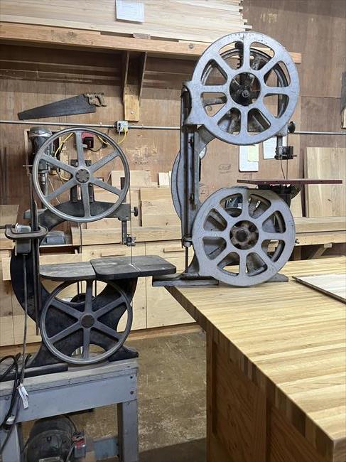

Own photo

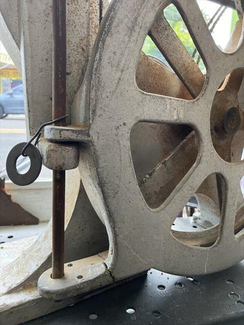

closeup lower guard
me
