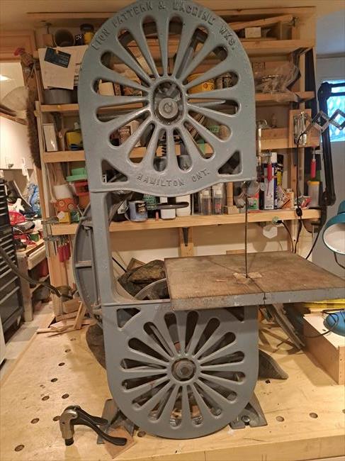

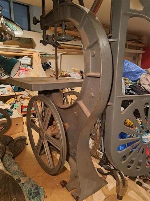

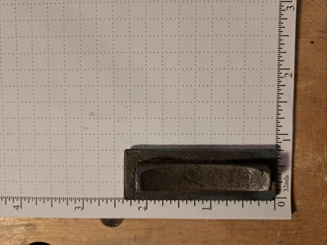

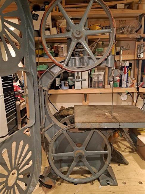

Recently purchased this 12" bandsaw on kijji. Came with a 1/2 hp westinghouse motor. Wheels are cast iron. Needs new tires. Appears to have been last set up for cutting non ferrous metals, blade speed is 903 sfpm, 10 tpi blade. Plan to change drive pulley to get speed up to somewhere around 4,000 sfpm. Missing on of the lubrication reservoir caps, shown it pic below.
12" dia cast iron wheels
Jimb58
12" aluminum drive pulley

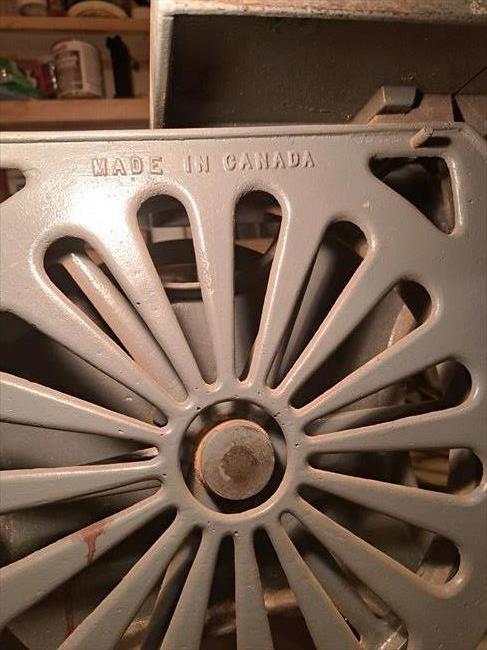

lower section of door
jimb58

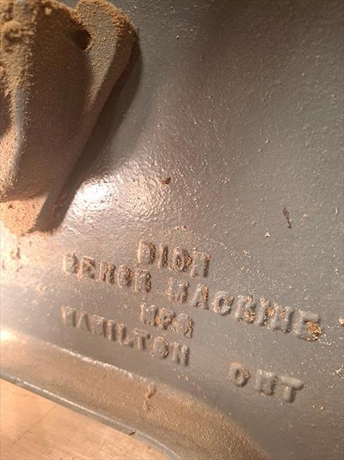

lower back side
jimb58

Lubrication reservoir cap
jimb58
