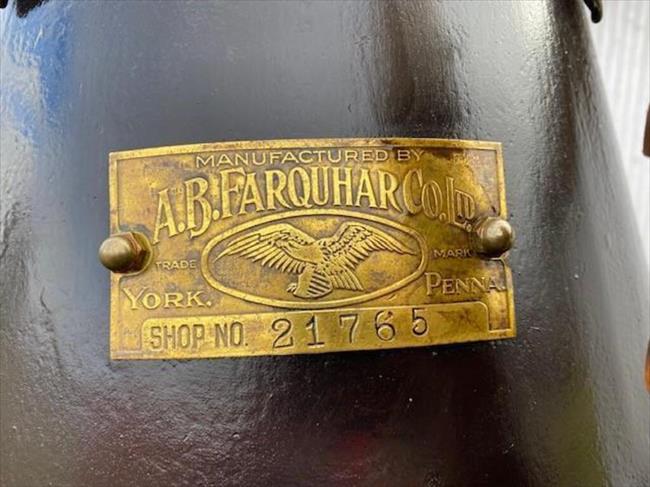

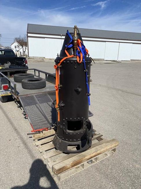

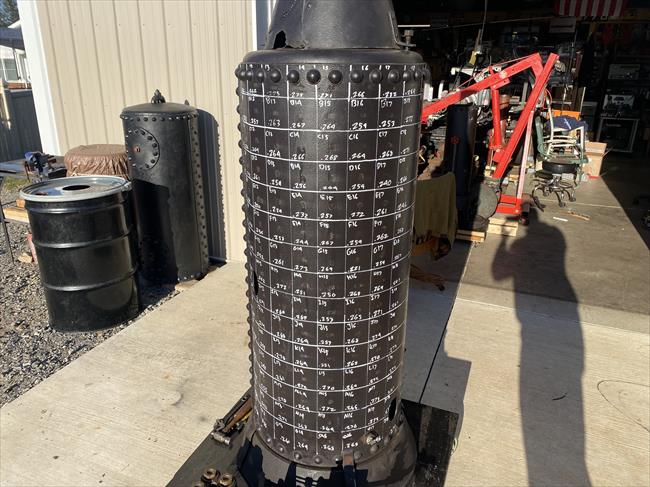

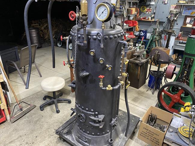

Vertical AB Farquhar boiler I picked up in 2022 in Ohio. When I got the boiler back to my shop, it was thoroughly UT thickness tested and hydro tested to 1.25x the MAWP of 100 psi. The boiler was then fired up and has been a great steamer ever since. The stamps indicate the boiler was built in 1933. I fitted the boiler with a 1/2” penberthy and set the pop for 75 psi.
