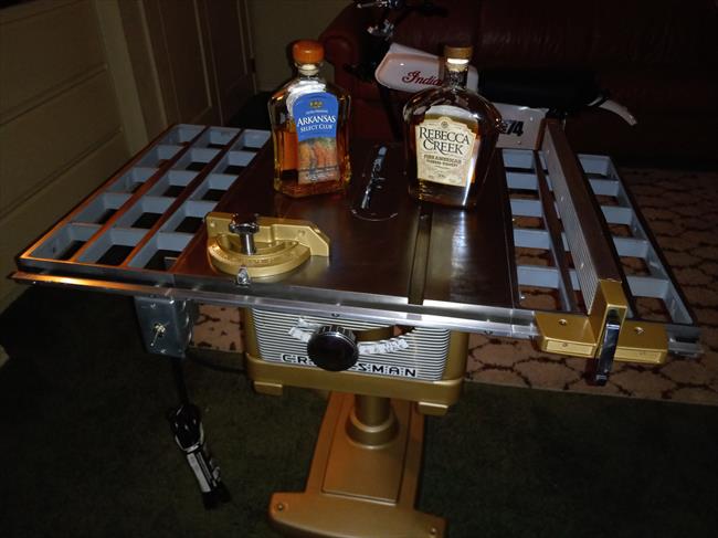

Repainted in the original Craftsman Powder-Bronze color using a True Value XO-Rust "Bronze" paint product that is a dead on match. Saw has the original factory "grid-type" extension wings on it repainted in the same smoke grey color they came with. The pedestal stand cast out of North Texas and was the older Model 80 8-inch bench saw version with the motor mount behind the saw and not mounted to the back of the saw like this version bench saw is. I slightly modified this stand to fit this newer much nice motor mount version on this bench saw.
This saw has a green link belt, machined and balanced arbor and motor pulleys I added. Saw is running a new CMT 40-tooth 8.25-in. blade that is a very nice quiet all chrome plated blade.
This table saw is going to a new owner here in Harrison Arkansas who works with me at the United States Postal Service.
Front View on Optional Pedestal Stand

Both the Nickel & Whisky Vibration Test passed with ease...LOL
