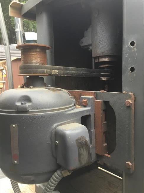

Mine has a 3” tall drive pulley on the motor shaft, also not seen before. No fence or miter gauge were included with this machine.

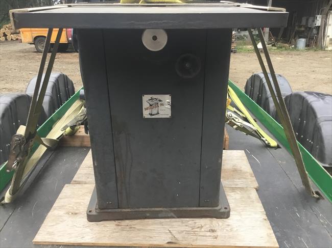

Comments: strapped down for the ride home
Source: me
Comments: 3ph motor and drive system
Source: me

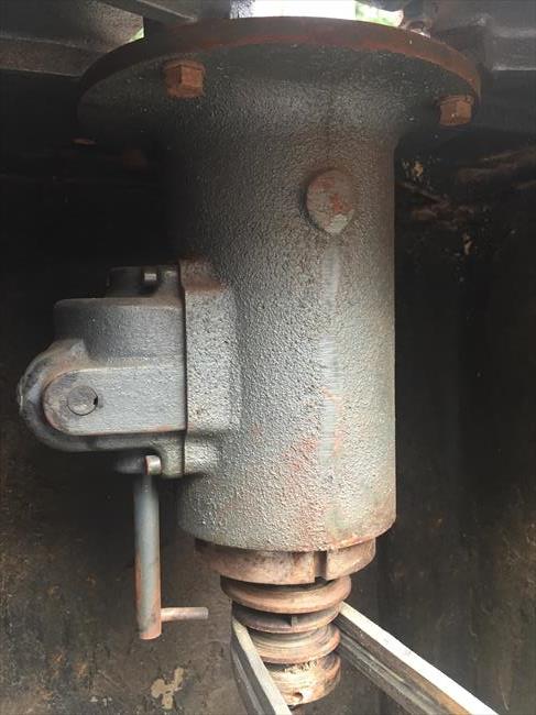

Comments: spindle and housing; similar but different from the Boice Crane version
Source: me

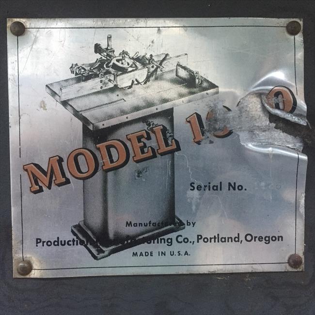

Comments: tag with serial number
Source: me

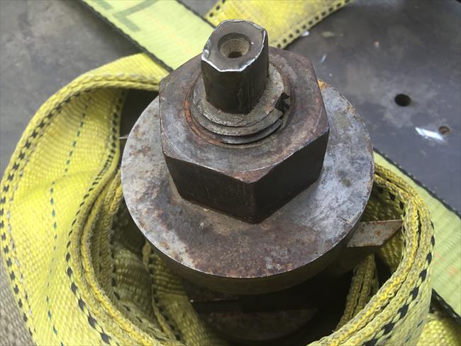

Comments: 1” spindle and top view of a bevel edge knife head
Source: me
