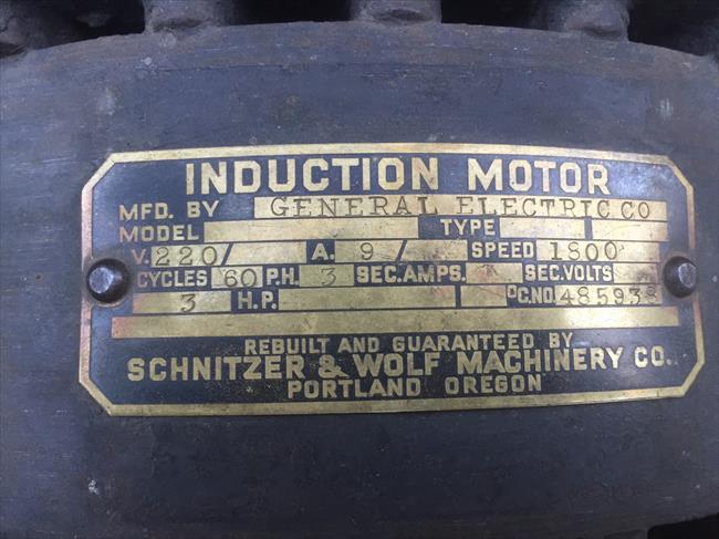

This machine came to me with a substantial (older-than-the-jointer) General Electric motor that had been serviced and rebuilt by a Portland firm unknown to me: Schnitzer and Wolf Machinery Co.

Motor tag
