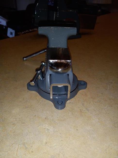

Purchased off eBay out of Maryland and restored for a friend at work.

This vise was in exceptional original condition seeing very little use or abuse.
The jaw top surfaces, jaw sides and anvil surface were flap disk ground to to level out and remove some very minor indentations.
The anvil horn was ground and refined way past what Columbian did (painted red) so this could be used on curved metal stock when necessary. All casting surface were top coated in an Awl Grip two part system in my Vintage custom mixed Craftsman King-Seeley grey color.
Restored right side view
