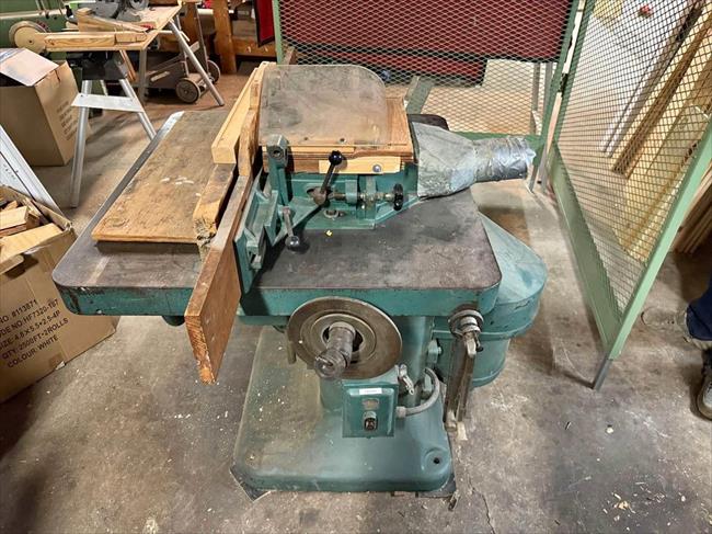

This spindle moulder was purchased from a custom window manufacturing shop in the wilds of Quebec, Canada (well maybe not that wild, actually rue des Frères-Moncion dans le secteur Masson). The senior shop hand that helped load my trailer said that it was purchased brand-new about 65 years ago but the window manufacturing shop has converted entirely to PVC window frames, so this machines have been sitting in the corner unused for about the last 15 years.
The fence is labeled "WACO" which I am guessing is Maskinfabriken WACO from Sweden. The senior operator from the shop where I purchased this machine said that the fence was original right from the initial purchase. I'm wondering if Valois & Valois had some sort of business relationship with WACO for supply of fences and possibly other components?
The machine probably weighs close to 1000 lbs. It has a 1.25" diameter spindle and a 5 hp 3-phase, 220/440v electric motor. The spindle is driven by a flat belt and two idler wheels to keep the belt tensioned.

Comments: Original photo from on-line listing, prior to removing dust collection shrouding
Source: Sellers photo
