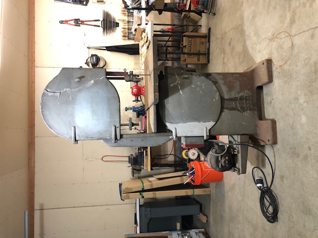

Comments: Heavy 20, alum wheel guards. Bright area on upper wheel is Scotchbrite test cleaning.

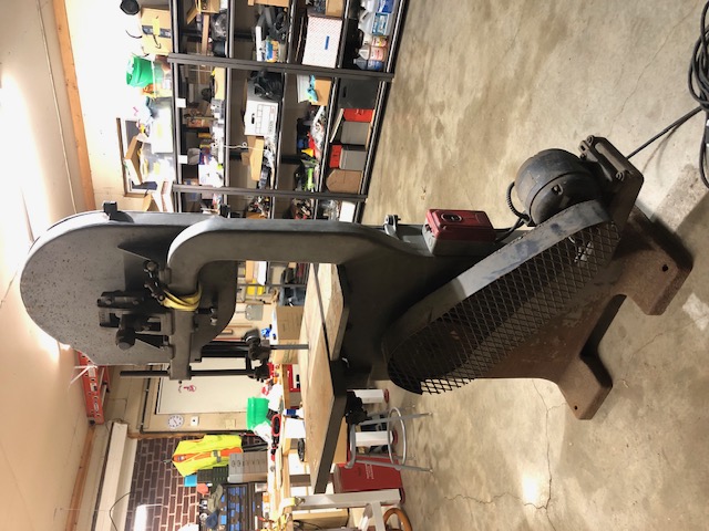

Comments: Heavy 20, Lower guard, white portion on lower guard appears to be sandblasted to allow welding repair at hinges.

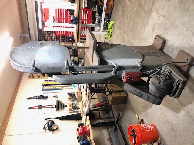

Comments: Note: Rigging point for engine hoist

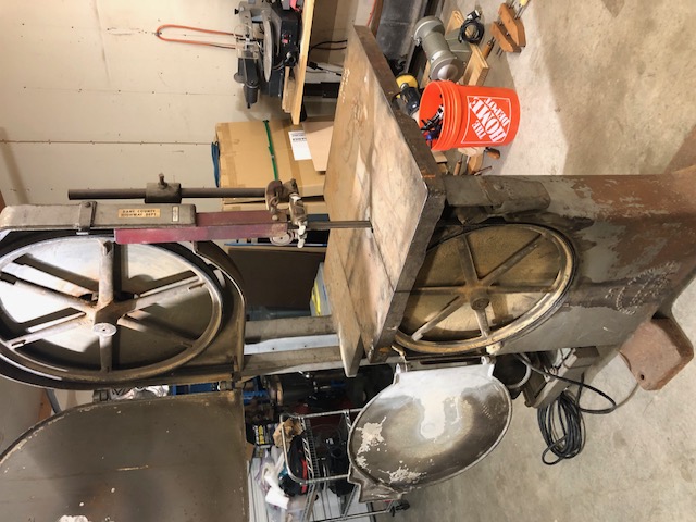

Comments: cast iron wheels, rubber rimmed

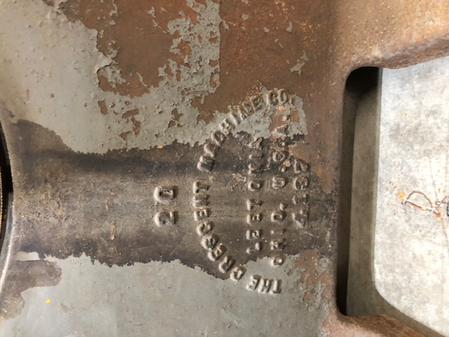

Comments: Casting marks on base

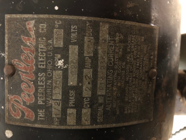

Comments: Motor badge, 3ph, 1750rpm, 1/2 hp
