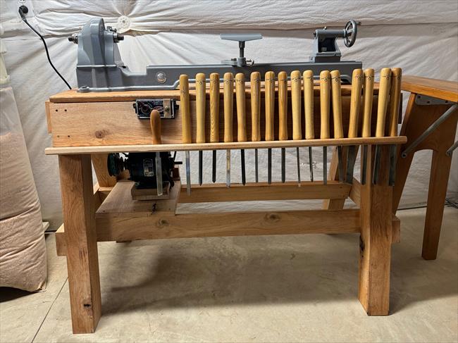

Purchased in east Pittsburgh from a woodworking machine enthusiast. He'd noticed a neighbor's trash contained old machine parts and inquired eventually purchasing this lathe. From the Driver catalogs the switch dates it to 1936 or 1937. This was an entry level 8" bed/10" gap swing lathe with a 30 1/2" capacity. Picked up a 100MM Axminster Evolution chuck and some older Morse Type 1 centers for the tailstock. Running as direct drive with the motor mounted below the machine with a link v belt on a hinged bed.
Comments: Walker Turner L540 w/oak base

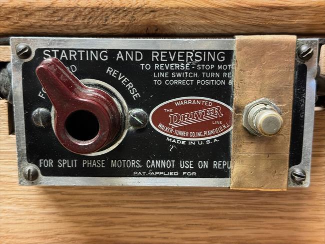

Comments: Driver Reversing switch...$2.95 in 1937!

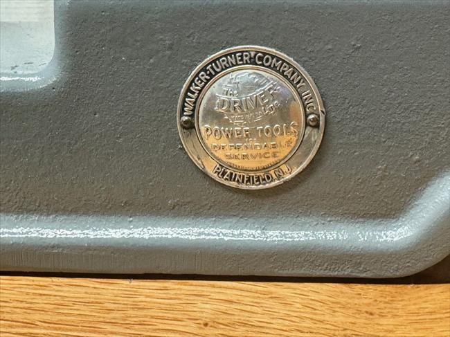

Comments: Walker Turner Driver Badge

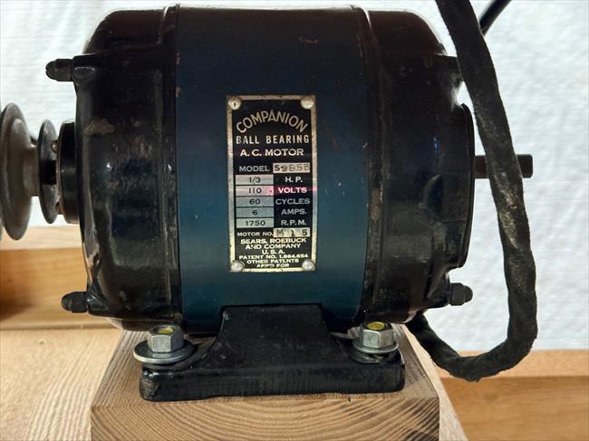

Comments: Companion 1/3 hp motor sold by Sears and Roebuck

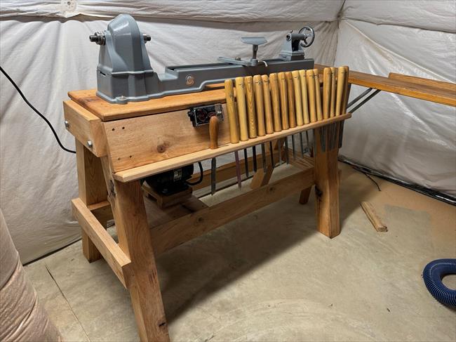

Comments: Lathe mounted on black oak stand with Buck Brothers tools

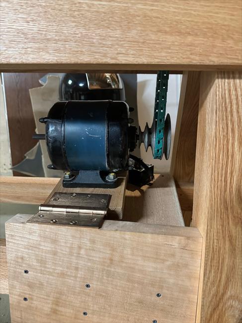

Comments: motor mounted below bed with link v belt
