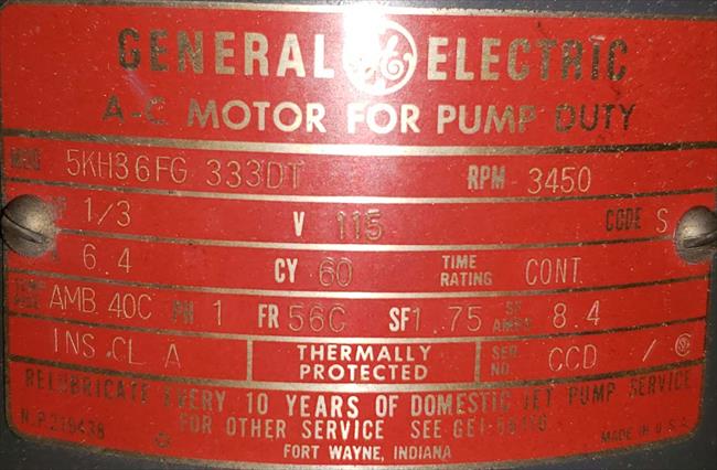

CRAFTOOLS, INC. NEW YORK, N.Y. 1/3 HP, 1-ph Grinder/buffer + 1/3 HP (GE motor) Dust collector/Exhaust under the cabinet. Total weight must be well over 200+ lbs. After unloaded at home, it burned two strip-surge breakers (!) due to multiple sources of electric short; 1) Light socket wiring is reversed (fixed), 2) Main power cable is worn and cracked (replaced).
The buffer/grinder appears to be re-badged Miller-Falls Bench Grinder.

label- Dust collector motor
my galaxy s9
